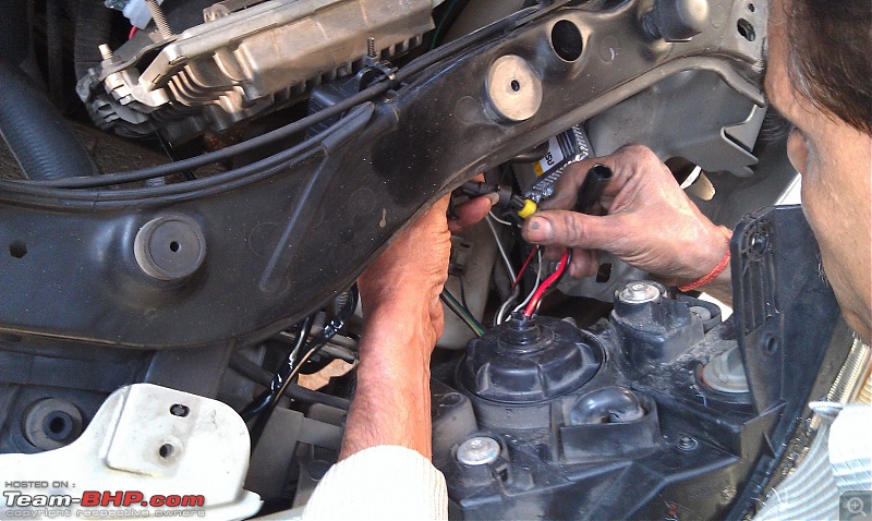

Wiring for HID lamps. Everything just has to be plugged in. No cutting of stock wires, no loss of warranty.

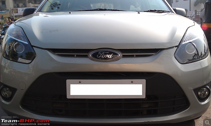

Looks wicked in the night!!!

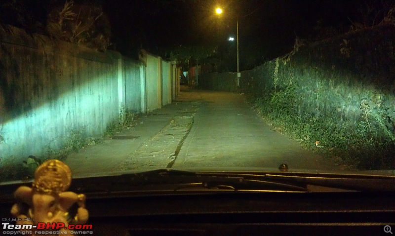

Low Beam
High Beam
Cut off is quite nice. Ends right below the windshield for the on-coming cars. So does not trouble them at all. This is one was shot when i was waiting for the traffic to move. Looks low because i was quite close to the swift.

@nayaknav,
Thats an awesome setup, the projectors looks super fantastic on the Figo. The cost also seems within the budget. The throw seems too bright, should it bother the oncoming traffic?
BTW where is the Sainath Auto Ulitmate located? Is it in Thane?
