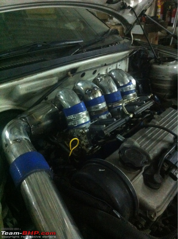

Making a plenum for the itbs is a task in itself. To reach the target volume, we needed to use a 4 inch id stainless steel tube. With not much space between the intake ports and the firewall the master cylinder has to be relocated to accommodate the new plenum. In the future we may go with a dual plenum.. But not anytime soon. Itbs are 43mm
Fabrication begins:

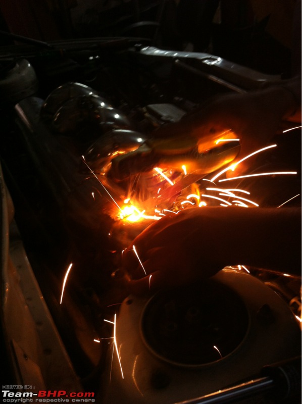

Runners are positioned, aligned and tack welded.
All done !

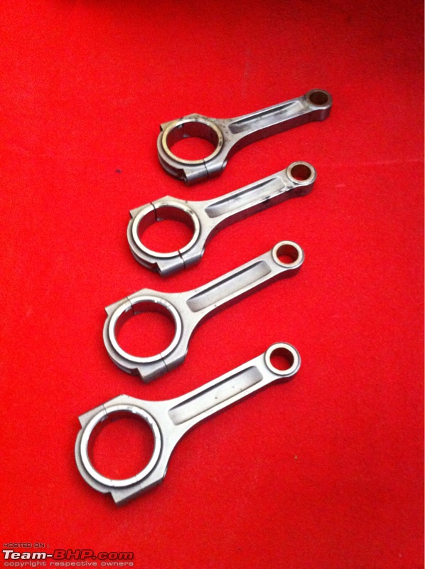

So things have come to the point of no return. The blocked has been pulled out to be machined. The stock conrods are being replaced by forged steel rods.

Stock rods vs forged
The set:

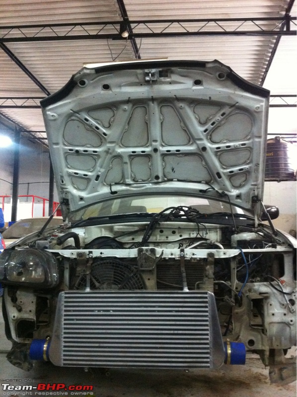

Since you've asked, the turbo is a Mitsubishi TD05h 16g, using it since i had it on hand. Its on the smaller side and will be upgraded once the bottom end is sorted out.
My intercooler is yet to come, have mounted a slightly larger(15%) one for the plumbing mockup. Will be changed by the end of the week

Originally Posted by pganapathy View Post
Oh wow. Now glued to this thread. Am awaiting more information and photos on the complete build. Wanna do something similar but with my esteem
Go for it. The stock engine on the esteem can handle a lot! Even on a budget, you can pull out a lot of power. What info do you need?

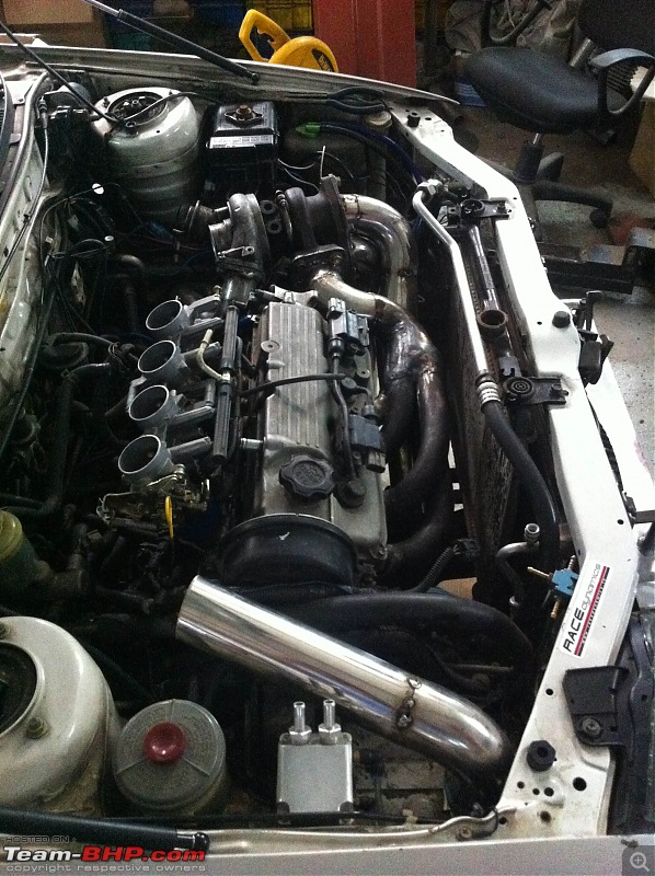

A whole bunch of parts came in today via Borderlinx. Bringing parts down has never been simpler with them. No hassles of customs, no delays being a dhl service and very economical shipping costs.
Most of these things have been bought for the sake of reliability - oil,water lines and metal gaskets for the turbo, t-bolt clamps and silicon hoses to keep things together under boost.

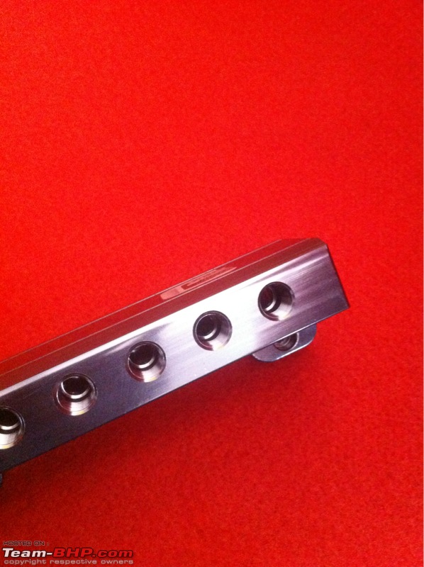

Being an itb setup, having a steady vaccuum supply is essential for the car and brakes to run right. That's what the vacuum manifold below is for. Along with the silicon vaccuum tubes we don't have to worry about leaks or hoses coming loose.
The injectors also came in - more on that later
