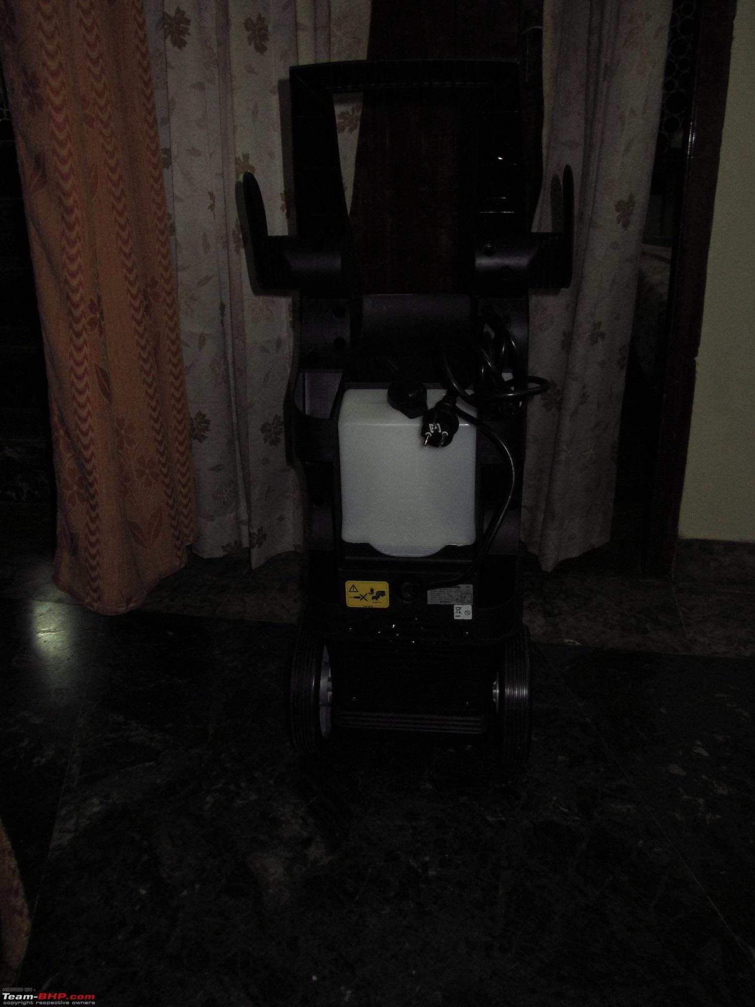

Went shopping for a pressure washer i had the Aquatak 1200 Plus in mind. But saw the Aquatak 150 Pro in the shop and came home with it. The exposed pump did it!
Few pics...
I had an Aquatak 100 Plus before, it was good for light usage but had an erratic auto cutoff switch which wouldn't let the machine work sometimes. Sold it. The new one with the wheels is easier to manoeuvre
Hi, could you please share the price details and pumps horsepower rating as well?
