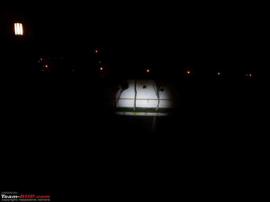

Pankaj I got it from US. There guys in Bangalore who have these but they charge 24k per light.
I got these
for 27k inclusive of 6k customs clearance for a pair. Later due to exchange rate change got a refund of 3k from Delhi customs. Took 2 days for clearance but its worthwhile. Don't have a lot of pics but these are 2 of them.
The beam shot of the wall is at 250 meters. Running a bit tight due to work. Will post better ones. Also worth looking are d2 driving lights. These cast a 30degree wide beam and can replace the existing HL easily.
