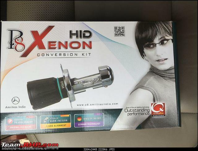

Thanks Anurag for detailed analysis. You are right that the ground wire you see on the tip of the bulb is what causing the shadow.
One more doubt I have with regards to the bulb is in the box at there is a metal cup like in front end of the bulb.
Is that too installed with the bulb or not required? If not installed, can you try one bulb with that metal cup?
I have seen that kind of cup-like thing in my Ertiga whereas it isn't present in my Swift so it all boils down on the reflector design.
What do you say?
No no, that was picture only thing. No such cap. The bulbs inside the kit were not with any cap at tip.
Attachment 1467475
What do you say?
That metal cap is for H4 HID kit. The photo is generic. In H4 HID bulbs you need the cap to switch from low to high beam since the light source is just one. In H4 halogen bulbs there are 2 filaments.
The XUV has H7 for low beam which is single filament. So the HID bulb will be simpler without metal shield.
Vid6639 is offline   (5) Thanks Reply With Quote
