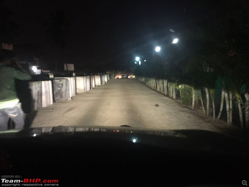

Looks like mahindra is right about not using HID in projectors.
Just received this photo from one of the XUV owner who had installed Osram HID.
The 2 shadow lines are present. The customer apparently told them that the shadow doesn't make any difference to him.
The onus on going for HID in XUV now lies with individuals.
Hope i was able to help. Cheers
