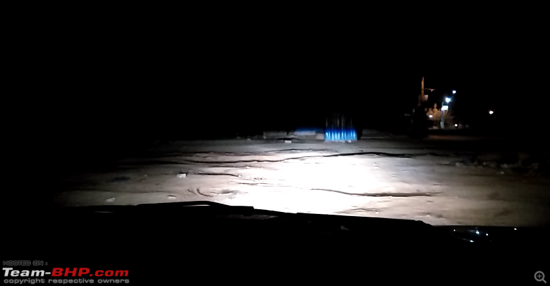

XP Micro: Bi-Xenon Projector Foglamps. EDIT: Terrible experiences-img_20170506_211203.jpg
The final output, with only XPs ON. Cut off on the right side seems to be not so perfect.

The near field visibility has increased drastically, crisp and clear now. I can even drive just with XPs on city roads.

Haha Finally!! I know you had waited for long time. Actually I had driven to Bangalore last week and had plans to reinstall my XP Micro. But I couldn't get it done as the main installer at EVO was not available.
Could you post few more wall shots?? The cut off of right side XP Micro is not aligned properly or is it bowing down to the ground?

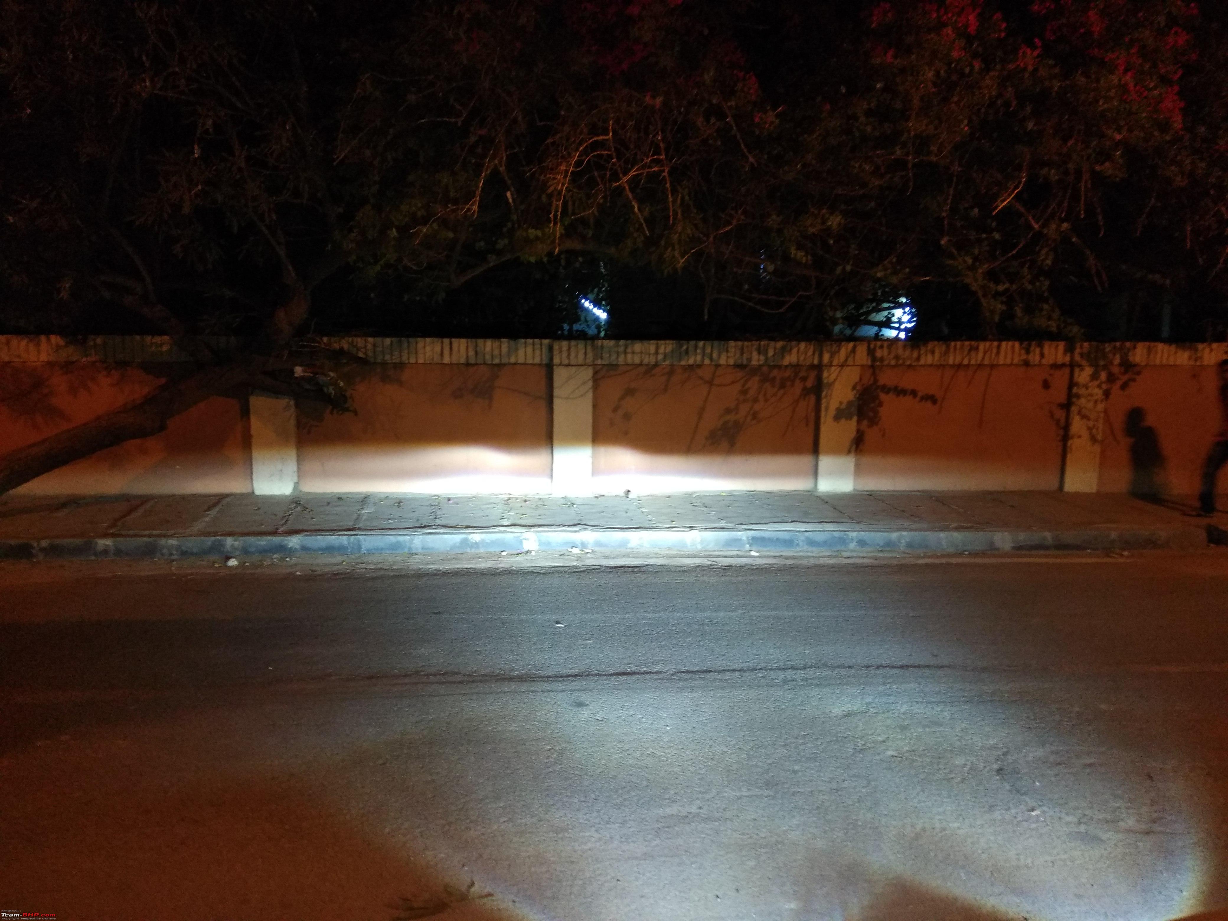

Beam pattern : Wall shots
Low beam
XP Micro: Bi-Xenon Projector Foglamps. EDIT: Terrible experiences-img_20170525_191959.jpg
Make sure to align the low beam of XP Micro below the stock HL low beam
XP Micro: Bi-Xenon Projector Foglamps. EDIT: Terrible experiences-img_20170525_195100.jpg
High beam (low exposure mode to capture the pattern)
XP Micro: Bi-Xenon Projector Foglamps. EDIT: Terrible experiences-img_20170525_190623.jpg
