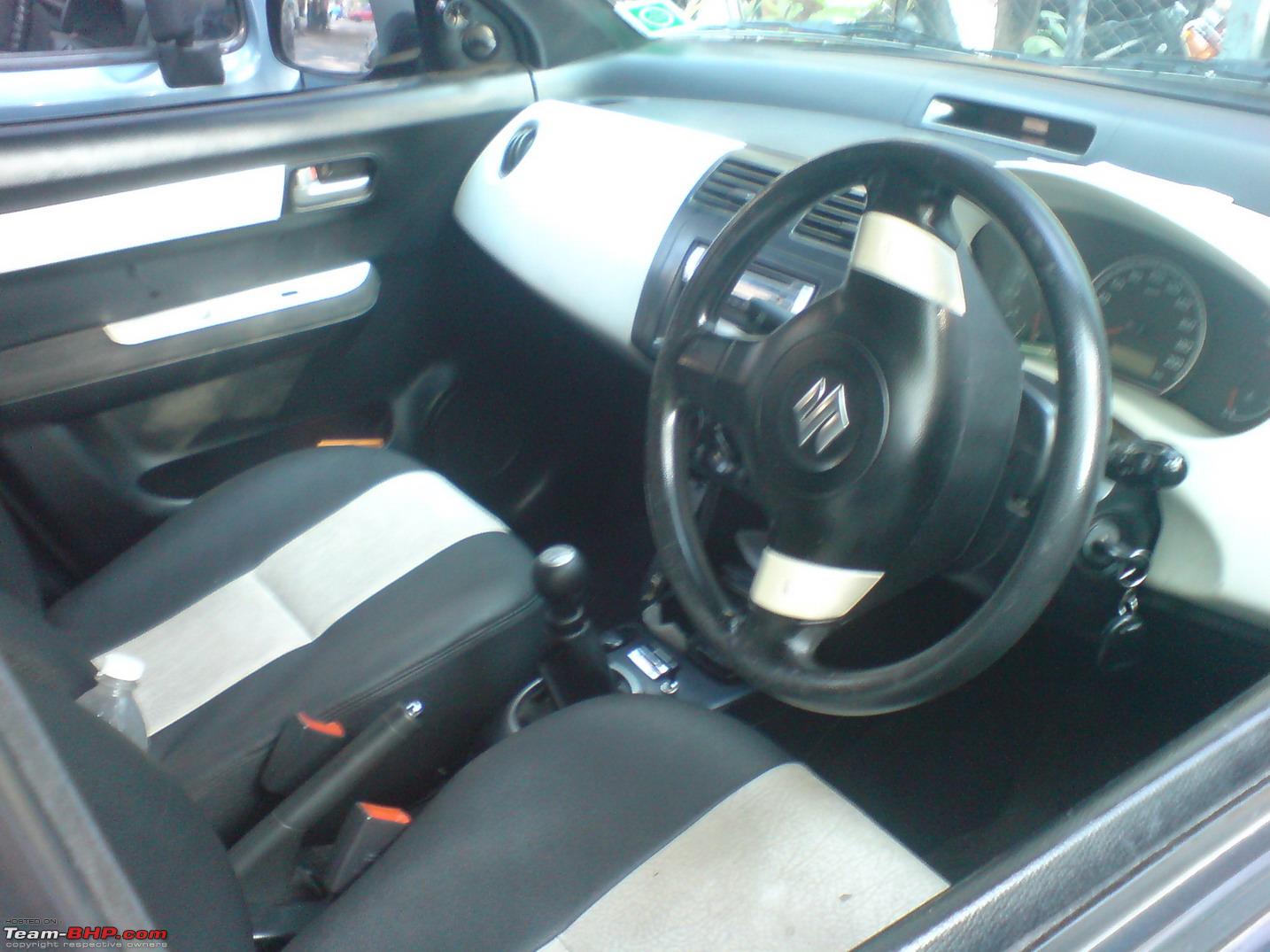

baleno swift conversion. N/a powerhouse

its my friends car...its really smooth and quite fast through the gears..more torque too but nowhere as quick as the turbo swift...however this car is very nive to drive with great performance....
the baleno engine has been modded too.
FFE
ecm
head and port polish
air filter
throttle body

Nice!! though the plumbing for the air intake could have been better. Isnt there space on the left for the CAI? I doubt the air will be cold when it passes thru all that piping right over the engine.
Also, is the power steering Hydraulic or electronic now?

Just a thought. In the third picture the intake filter pipe is seriously long. Wouldn't that hurt performance at the top end?
