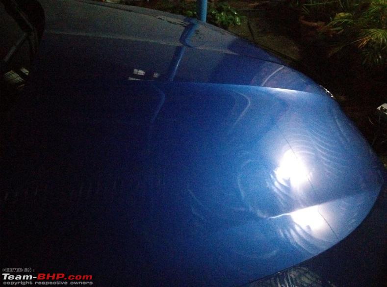

Here's how I do it :
I decant about 30-40ml into an oil dropper can from the main bottle. Dip main bottle in luke warm water for about 5 minutes and shake it for a minute till the contents get a water like consistency. Then decant into oil dropper.
Just before using, I again dip it in 5 minutes in lukewarm water. Shake it well for a minute.
Put exactly 4-5 tiny dots on the applicator pad. Nowadays I use a machine to apply wax but the process is the same.
Just these 4-5 dots are enough to prime the pad and apply wax on the bonnet. After that, put 1 or 2 drops per panel (1 or 2 dots depending on size of the panel). WHen applied , it should be only visible from extreme angles. If the panel appears white, you've applied too much.
This is ideally how the panel should look with the wax on.
Most durable wax I have encountered - Collinite 845-img_20160212_075424001.jpg
Use a high GSM thick towel to buff off when cured. A thick towel ensures the pressure from your hand is distributed evenly onto the panel via the towel and it can hold lot more spent wax.
Most durable wax I have encountered - Collinite 845-img_20160212_081959001.jpg
The thinner wax you apply, lesser is the wastage and its exponentially easier to buff it off.
