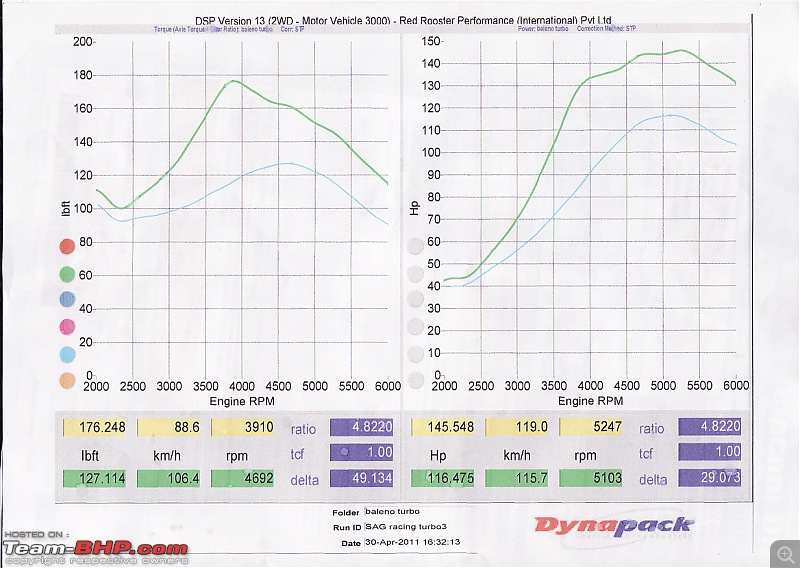

Dynoed the car again at ~10 Psi and got a really impressive figure of 145whp with the stock rear muffler!
According to Red Rooster Performance, this is about 182 Bhp at the wheels! Will post some pictures later, for now here is the Dyno Graph.

nice figures. giving tough times for newer sedans? can only imagine.

WOW WOW & WOW !! This is some impressive number. So the RRP facility is doing more than what it set out to do ! It is actually giving out numbers in real time & realistically so !! Congrats Binz on the build.
That's 182bhp at the crank .. Request the mods to kindly correct my previous post.
