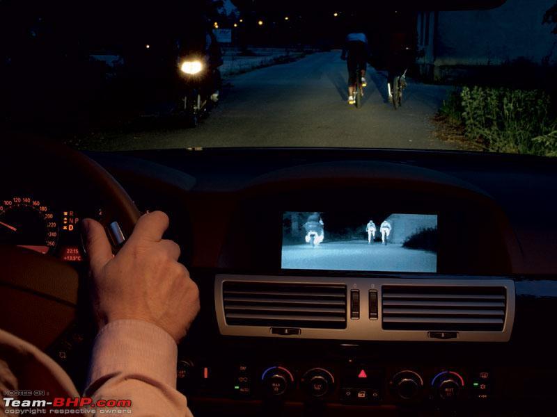

Default Found this on the net
BMW has thermal Night vision camera on them
its really good..

Looks like something out of Splinter Cell! Very cool indeed, and am sure it would be a useful gadget to have. But, that camera itself looks very vulnerable. Would always run the risk of getting damaged in our cities. And I bet it costs a bomb!
