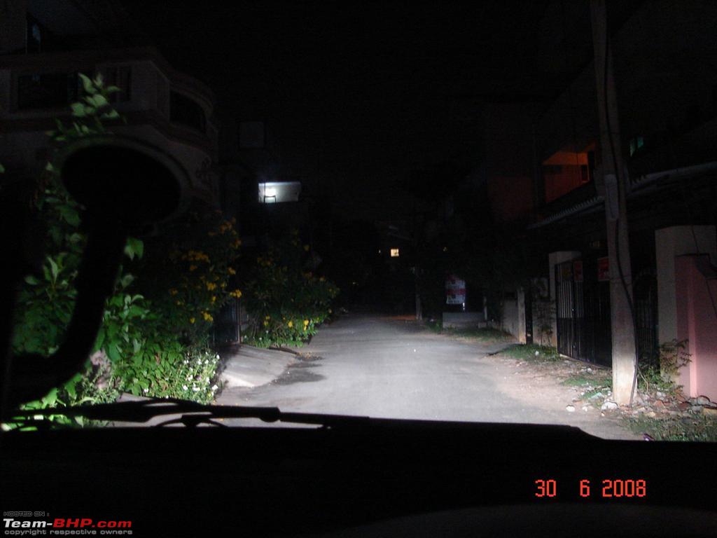

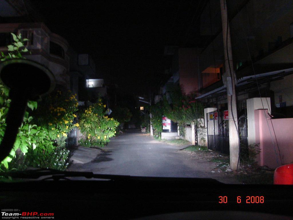

Photos of upgraded headlights for SX4
Narva 100/90 White - Low beam
Auto Lighting thread : Post all queries about automobile lighting here-narva-10090-low-beam-large.jpg
Narva 100/90 White - High beam
Auto Lighting thread : Post all queries about automobile lighting here-narva-10090-high-beam-large.jpg
gopinathann is offline   Reply With Quote

Originally Posted by gopinathann View Post
750 for the bulb and 750 for the relay.
did you wipe the bulbs properly before fitting. Even if there is little bit of smudge, the high beam can go "pop".
Also I would recommend carrying a couple of spare bulbs with you as these high power bulbs do not have as good a life as normal ones.
Attachment 25578
looks whitish, how is it in rains, philips rally is yellowish than these...

I could see better improvement in rain compared to the previous ones. Always yellows are better than white, however I also wanted some looks so went for this one.
