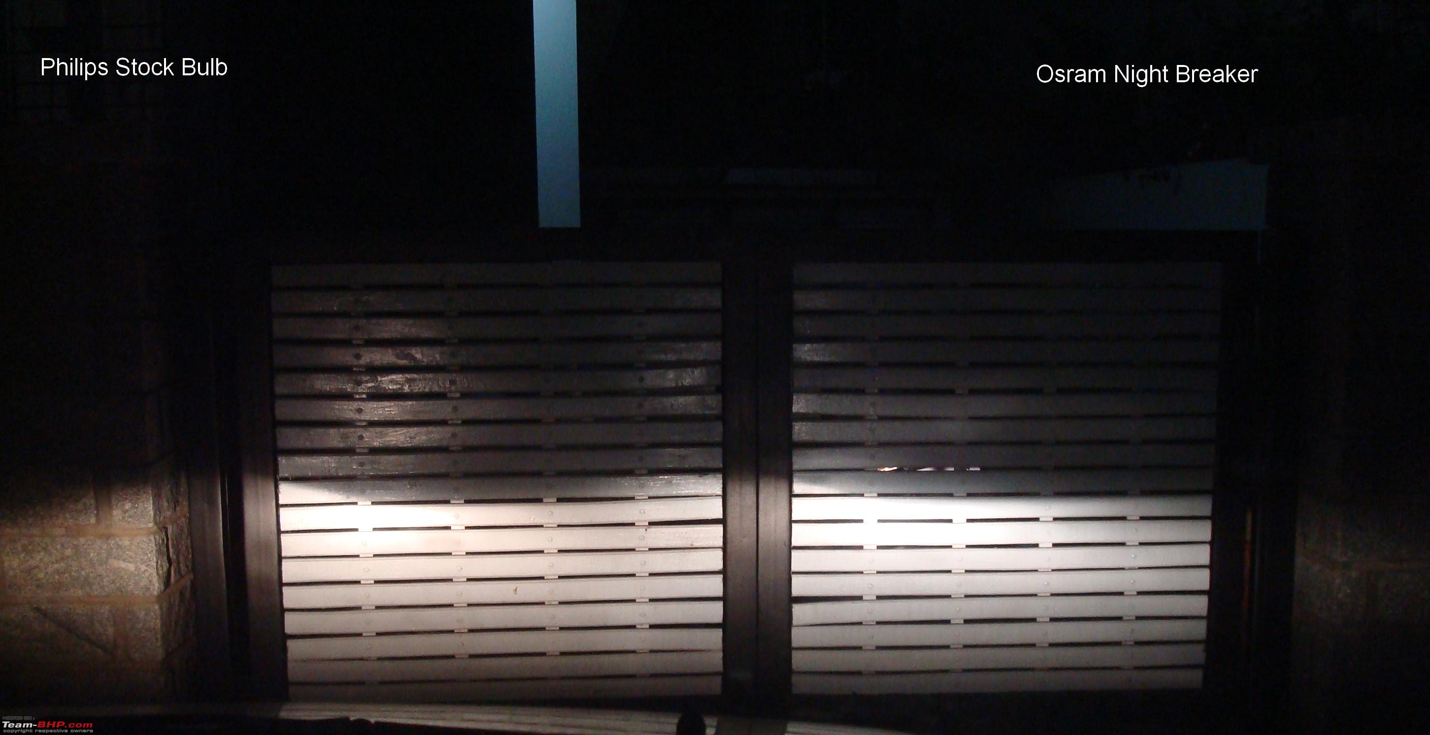

I upgraded my ANHC, headlamp bulbs with Osram Night Breaker H4. I got a pair of bulbs in a near by shop for Rs 800/-. I found these better than the stock bulbs, it gives whiter light and and more focused beam.
However, in rains I find them not so good because of the rain drops the dispersion of whiter light it high and most of the street lamps are Sodium Vapor lamps giving out yellow light which over shadows the headlight beam specially in rains.
On a clear night these are definitely better than stock bulbs. Also have a look at Philips X-treme Vision, I couldn't find them at shops near by.
I have attacked picture of the Night breaker and Stock bulb on my car for comparison.
Auto Lighting thread : Post all queries about automobile lighting here-dsc02708.jpg
Auto Lighting thread : Post all queries about automobile lighting here-dsc02707.jpg

@aa-Crecy - That's an AMAZING price you paid for the Nightbreaker. The distributor here also does not sell it for so cheap. I hope you got the genuine one or maybe I am getting conned. lol
Whiter the light, more trouble during fog/rain. But these are much better than many other bulbs!
