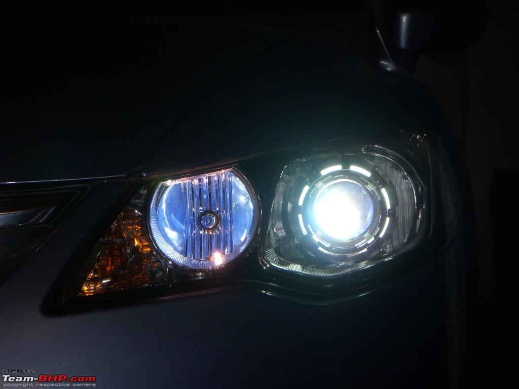

Update.
My CIVIC with FX-R Projectors.
FX-r 1.1 Bi-Xenon Projectors
Morimoto 35W D2S Bulbs
Gatling Gun shrouds
Auto Lighting thread : Post all queries about automobile lighting here-dscn4415.jpg
Left Indigo with 130/100 Halogens, Right my Civic with FX-r (both Low Beams)
Auto Lighting thread : Post all queries about automobile lighting here-dscn4456.jpg
Auto Lighting thread : Post all queries about automobile lighting here-dscn4362.jpg
Low- Beam - FX-R
Auto Lighting thread : Post all queries about automobile lighting here-dscn4385.jpg
I have replaced the Morimoto H1 mini Projectors with FX-R Projectors.
Thanks Anoop (Digital-Vampire) for helping me out in getting this Morimoto things done, Though it was a messy job I know but those 2 days were cumbersome. Once again thanks for all the effort you put on my headlights & also for Gyan.
Joice Willi (litessence) for helping me out in fitting the FX-R projectors.
For both of you I'm whole heartedly thanking you for the efforts you put in my car.
