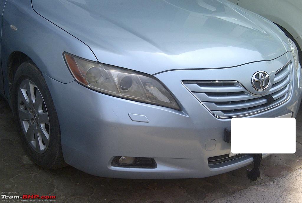

Okay I got some pictures - note the difference between left and right headlamps - you will understand my problem. And give the appropriate solution...
Auto Lighting thread : Post all queries about automobile lighting here-car.jpg
Auto Lighting thread : Post all queries about automobile lighting here-img2012041200008.jpg
Attachment 915572
Attachment 915564
I have a feeling a good headlight restoration kit will work for you. If you don't get it in India you may have to order it from abroad. Search for 3M headlight restoration kit to know more details.
3M
This will work if it's on the outside.
If the dullness is on inside the cheapest option is to get a professional to remove the outside plastic. Look at this thread where they remove the outside plastic by heating with hot air gun:
https://www.team-bhp.com/forum/techn...est-shine.html
Once the clear plastic is removed, get it cleaned with the restoration kit.
Easiest but expensive option you already know is to replace the headlamp.
Vid6639 is offline   Reply With Quote
3M
Okay, I did quite a lot of research about the same - rang up dealers etc etc - only viable options are 1 and 3 since I'm not at all comfortable getting the lamp opened (otherwise why would I kill my desire for angel eyes and a second projector
I will check tomorrow if it's external or internal - though I still feel that restoring it won't match to a 2 month old headlamp, but somewhat close indeed - currently the light scatters and does not throw a straight beam thanks to the rough and faded surface.
I also did research on eBay an OEM headlamp costs around $60-$100, which is not SO bad, but now that the Camry will be built in Chennai, I assume spares will be slightly cheaper - any approx estimates or guesses ? If anyone has a clue about Altis, Camry can't be much more than the Altis I assume.

You can try using any compound/polish that you have on the lamp lens and work it in a small section to see if there's any improvement.
Any suggestions (brands/material) for the same ? I have never done this before and there are just too many types talked about out there (searched about the same!)...

Any mild rubbing compound will do the job!
Best would be Meguiars ultimate compound as it will cut hard and finish nicely as the abrasives break down! (good one step product).
Afterwards, use the sealant/wax of your choice on the lamp lens to protect it from UV!

Rub if you must, but be prepared to have a solution worse than the disease. If you must I will suggest use jewellers rouge.

Just found out that the 3M kits start at 3500 and go upto 9000 for the basic ones, I don't have a drill, neither am I confident about this DIY.
On the other hand a RH headlamp assembly starts at $40 goes upto $80 with $30 to $50 on shipping+customs. Toyota guys I think won't charge more than 7-8k for the entire assembly replacement.
While ebaying bumped into some cool and affordable assembljes such as:
07-09 Camry BLK CCFL Angel Eye Halo Projector Headlight
07-09 Camry CCFL Angel Eye Halo Projector Headlights 08
07-09 TOYOTA CAMRY CCFL HALO PROJECTOR HEADLIGHTS BLK + "L.E.D." TAIL LIGHTS LED
07-09 TOYOTA CAMRY DUAL CCFL TYPE ANGEL EYE HALO PROJECTOR HEADLIGHTS BLACK PAIR
Will either of them suit the car or I should go for only RH assembly replacement from Toyota or US dealers depending which is cheaper ?
suggestion welcome from all, pictures of the car are a few posts above.
