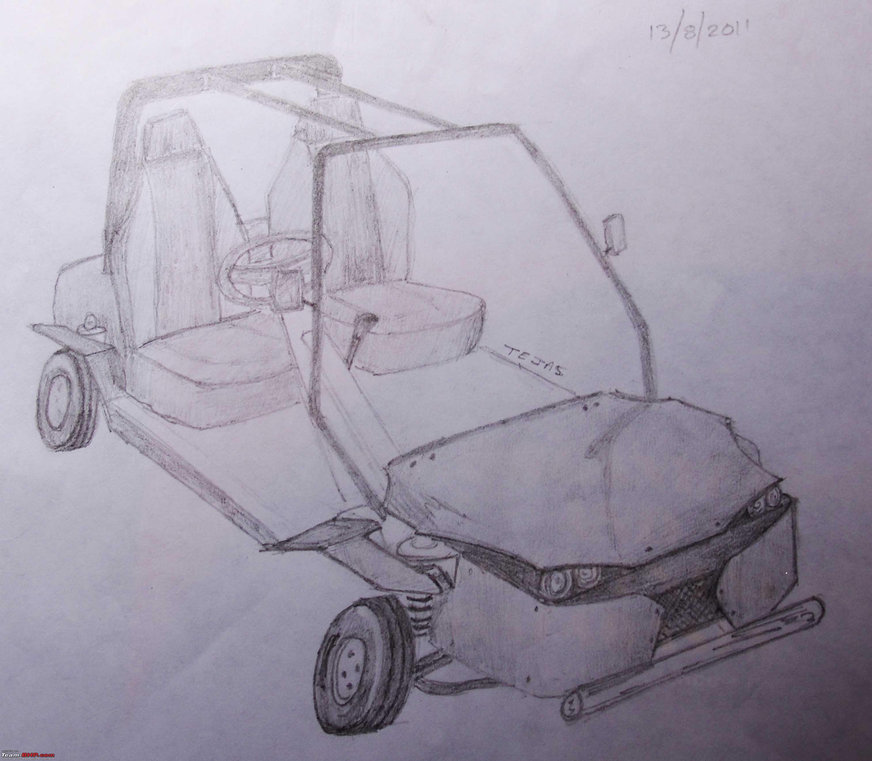

This is what I have planned for the car. It will be made using mainly fibre sheets and metal for the floor. This is a low cost design which wont require any moulding or denting stuff.
I would like to know the purpose of this design.
Aesthetic / practical?
Your car looks great as it is.
Your design looks lean and mean, but we will get a better idea if you can draw a Front and side view rather than a 3D image.
Is it possible to fit Wego's 12" wheels?
Those are alloys and will really add to look of your car.
Not sure if it can bear the weight.
silverado is offline   Reply With Quote
Old 15th August 2011, 17:49   #81
Tejas Ingle's Avatar
Join Date: Dec 2010
Posts: 272
Thanked: 310 Times
Default Re: Made a car out of scrap
I am unable to drive the car around more frequently in its present form. Also when I will drive it after giving it a body, it should look appealing. So the purpose is both practical and aesthetics. I would be able to use it on internal roads for transport or carrying stuff around once I get a body.
It wont be possible to upsize the wheels because then the engine will require a lot of torque to drive the car. I'll have to retain the same wheel size. Since I am using light fibre sheets, it wont be very heavy. It will deter the performance a bit though.
I'll upload orthographic images ASAP.

Tejas, I think you have a great design! I would like you to add some side bars on both sides for additional protection & safety.

You have got your basic work right. Start building it and as you proceed you may be able to innovate a lot further. providing certain protective strips for personnel safety as aired by 1self, would be fine. Hope you would shift a gear and accelerate. Success would be yours. Details on finer aspects would be posted.

I would go by what most folks have articulated, lets not go the composite/metal sheet way. The car already looks beautiful. I feel additional coverage may have negative effect.
Yeah, I am thinking of some more ideas. The rear design is not yet finalised. I am also thinking about the bars on the sides.

Hi Tejas, the design looks good. I think you better make the roll cage bigger than the seating area for better protection range & also put a cross bar at the corner of the roll bar for head protection (if any roll happens, wish not!)
Suggesting this roll cage design for better safety. Start the roll cage from the suspension top for better rigidity & strength. All the best!

Tejas, avoid complicating things. Stick to the basic roll cage and other safety features. I liked the design that @tantragna has drawn in the above picture.
Upload a better image of the design, thus giving us an idea of what you can do.
I have put the bend since otherwise the bar comes directly in front of the driver. But I am trying to eliminate the bend. Starting the roll cage at suspension is a good suggestion.

Great work Tejas. I appreciate your dedication towards your dream. Many a times it happens that after college we hardly get time to give a better shape to our projects (may be because we are too happy that we cleared the subject and are out of the college. In fact my project of electric two-wheeler is untouched after my engineering).
Now coming to your design, the main function of the frame is to enhance safety. In my opinion more cross bars will improve the design in terms of safety. Hence sometimes we need to compromise on the structure looks. For a concept like yours, it is really necessary that the structure is slightly bigger than the chassis itself. Looks like you have concentrated more on the top side than on the sides. Do improve the design on the side walls as well. I found a structure(online) where you might get some ideas for your new improved designs.
Try to cover even the engine with this structure. This will also help you when you design sheet metal for the body aesthetics. Another key point is to make sure you have more of curved joints in the structure than sharp bent joints. The stress distribution is even in curved joints, minimizing the chances of failure at joints.
Waiting to see from you some more improved sketches on the structure.
