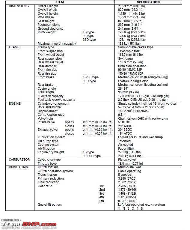

Specifications of the NXR 150, most of them apply to Impulse:
Some of these specs are not mentioned in Indian owners manual, looks like Hero only copied the bike but wrote the manual on their own
