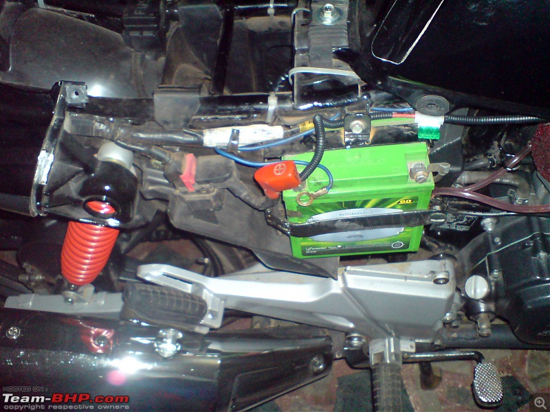

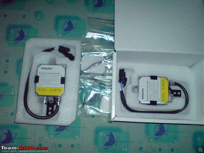

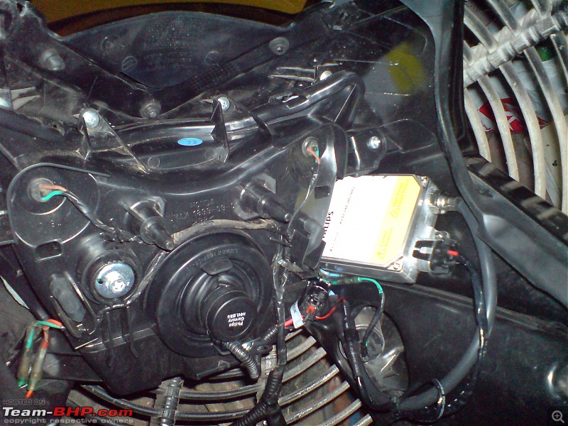

I got the HID kit last evening started installing at around 930pm got over with it by 0000hours Routing the wire as neatly as possible was the major headache, there's too much of it. Second was mounting the ballast, which was solved well. Below are the photos of my HID kit and installation, there ain't many, since i was too excited to finish it rather than take photos.
*Pic number 6 is the HID relay cum control box.
*Pic number 7 is the +ve lead to battery, it has an inline 30Amp blade fuse.
*In pic 8 you can see the three pin plug that plugs into the stock headlamp wiring.
*In pic number 9 you can see the ballast mounted next to the headlamp using a double sided sticky pad that came with the kit.
*Pic number 10 shows you the little screw screwed in flush that secures the ballast with a screwnbolt arrangement.
