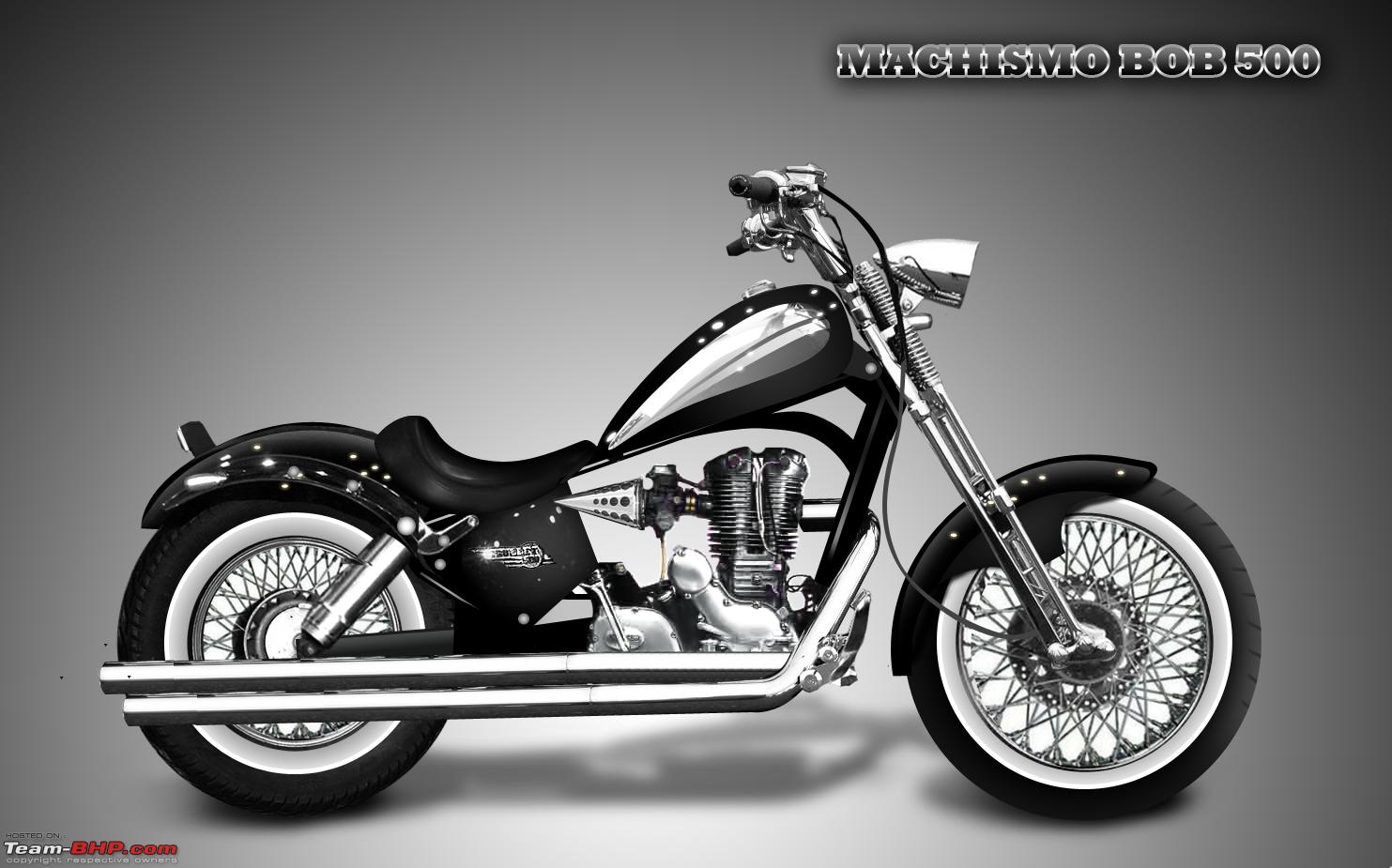

Tire sizes finalized ( or maybe not )
Rear - 140/90 15 with Avenger Rim
Front - 130/70 18 with RE Classic Rear Rim
The stock swing arm was unbolted, and an old 5" extended swingarm was inserted to check if the length would do, and it was good. He has to make a new one this week along with the rest of the accessories. The over all length of the bike will be somewhere around or above 7.8ft.
I finally got some time to do a cut-paste photo edit render of what I had in mind as far as the design is concerned. I came up with this (check attachment). Its not true to the traditional sense of a Bobber, but it is what I would be comfortable with. A modern generation styled bobber
The wheels are 80+ spoke rims. The modder said he knows a person who did this successfully for another bike, and will have to contact him to see if he can take it to the next level @ 80 spokes per rim! If not, then its back to the usual 40 spokes.
The tank will be a slightly stretched one by 3 inches and will have similar chrome - black color combo as in an Original Machismo. I wanted to stay true to how the Machismo looked, rather than to have stripes or flames on them. That would be overkill.
I know the picture is not accurate to every nut and cable, but it did give me and the modder a final image on how it needs to look like at the end.
Do let me know your comments.
Edit: Oops, looks like front fender is missing!

pictures are great jocreative!
but my vote for second one. (with single exhaust)
white wall tyres? branded or regular tyres with DIY paint job?

I like the second one too. The rear seat will be a detachable one. It's just for those rear occasions if my wife decides to join in .
Tires will be normal ones with a paint job. If the rims can't be done here then I will be importing both rims and a set of branded white wall tires.

Looks great!
Especially the second one. However, can't the exhaust be just a tad bit shorter?

The front looks good , but IMHO it must be a little low slung. I did not like the seat and rear fender arrangement. It looks more cruiser(ish ) and has no flow. The minimalistic look which the triumph bobbers had is missing.
The exhaust need to be chopped to get the authentic bobber look. I am comparing the rendering with the Triumph Bobber.
Sorry, if I sound a bit harsh in my comment.

joe! the render looks great! All the best with your project.
