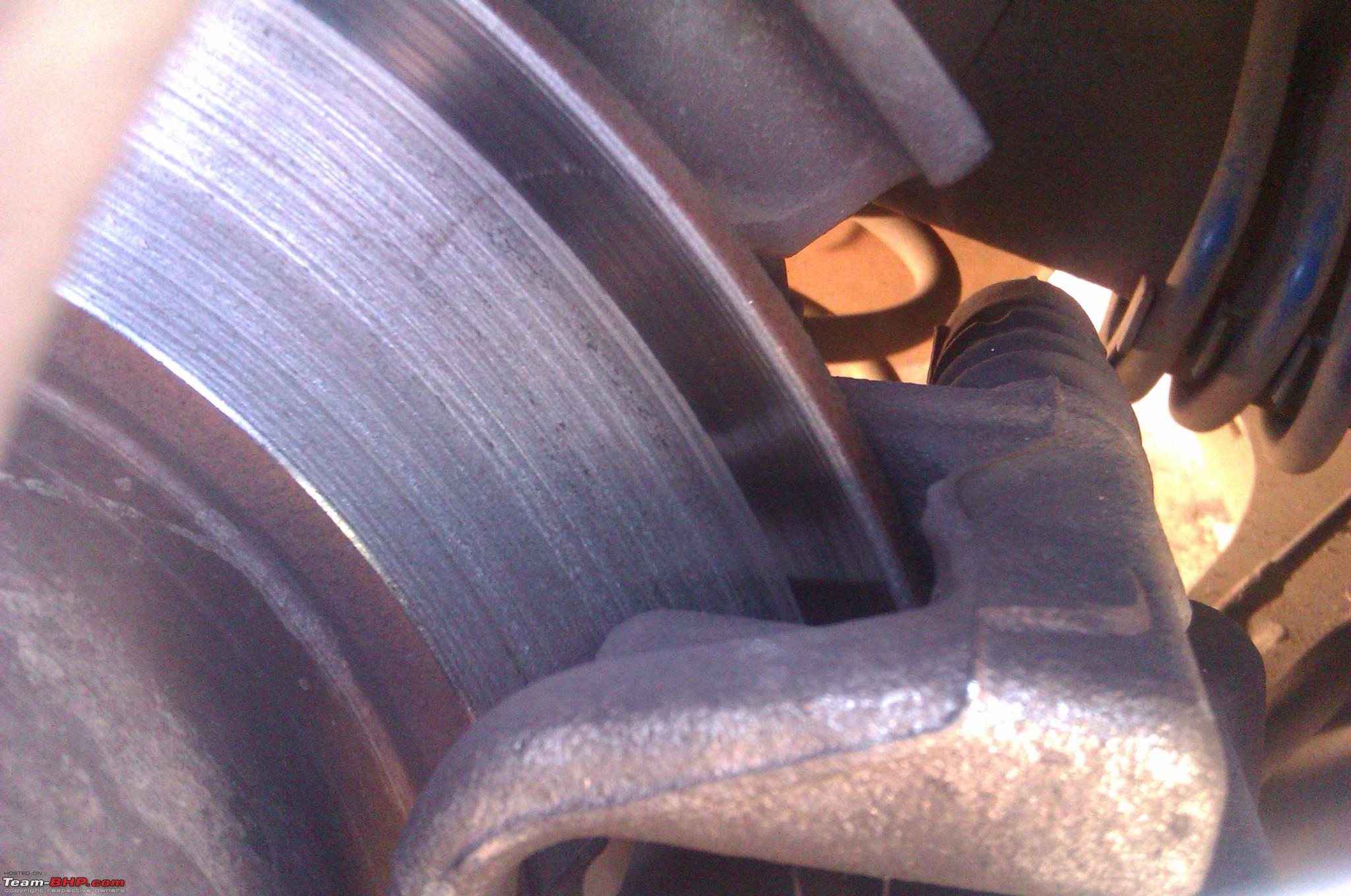

Hi all, the brakes on my T-jet have been making noise for a long time. I got it checked on several occasions and was informed that it's 'normal'. They even charged me once for cleaning it. It used to make noise in the morning or after a wash or after being parked for long, the noise used to subside after a long drive. I also brought to their notice a line that appeared on the disc and was informed that a stone chip or something might have made its way between the disc and the pad, so all's well.
O boy I had exact same issue, followed with same agony with dealership and Fiat and I was given the same reason of wear and tear.
I had this slight judder and told KHT motors guys to check the brakes which religiously they did not do. I was told confidently that the brake is all fine. I went to chennai and in the mid way the juddering became noisy and I knew the disc are gone. KHT did not check the worn out pads which eventually damaged the discs.
I called up Fiat claiming this negligence by KHT but in vain and I had to cough up for the rotors and pads. I was ready to pay for the pads but not the disc, but Fiat could not defend me in this case. Have to live with this fact.
Ended up paying 8k for one disc and a pair of pads. My car has done 35k ams.
EDIT: I got a call from KHT asking for rating on a scale of 10. Leniently I gave 3.
Here is the pic of damaged disc.

The pads have more than adequate life left in them and there is a mark on the brake pad because of the worn part on disc. While I am mentally prepared to pay for the pads and get them changed, shall I not push Fiat to include the pads as well? My car has done ~24K and the pads clearly shall last for another 10-15K thus, the issue is not with the way I drive rather a fault (perhaps manufacturing) with the disc. The response from SA is that the pads should have worn more than what they have so, they must be hard and should be changed. Here are the pics of disc and the pad. Do you all feel the pad needs to be changed or is the dealer just pushing for a premature change?
This is a nasty cut. While it's possible, I find it difficult to imagine how a stone got in there and managed to create so much damage. And if this was reported previously, and the brakes were simply cleaned and returned as "OK", then the service center should also share the responsibility for sweeping the early dust under the mat.
Try writing to Fiat. If you have proof (Entry in the system or the copy of the job card that they give you when you give for service) that the issue was raised previously, please add that too. The brake pads are generally replaced when the rotors are replaced. In your case, the brake pads also have a 'line' on them and they should be replaced. If the rotors are included, then the brake pads should also be included.
This is the challenge. We take our cars to the FASS in the anticipation that they would do their job correctly. I can understand Fiat refusing the warranty if you were informed about the worn-out part and you refused to change. However, in this case KHT seems to have missed one of their tasks and made you pay for it. In my case, they can't even put the blame on me for running the car with worn-out pads. Still, I have been asked to shell-out 6K. Another surprising part is that you were charged 8K for disc+pads and they are quoting 6K only for the pads.
Based on a discussion with someone in the dealership, I understand that most Fiat dealers are operating at a negative EBIDTA. Can this be reason for avoiding general check-up and ensure part-failure? They also tend to push for replacement of parts prematurely as irrespective of whether it's under-warranty or paid, the dealer makes money on every part that's changed.
One set of pads cost 5k odd and one disc cost 2k odd that makes 8k in total. They did not charge me for labor as a 'GOODWILL GESTURE' . Anyways my car is due service this weekend and I have taken appointment with Vecto this time. Crossed my fingers.
Anyway returning to the brake, they told me that the mark (which I had earlier pointed) is a cut on the disc and it has to be replaced. I brought it to the notice of another SA (the one that listens) and he agreed that it can't be due to my fault as the brake pads have more than 15K kms life left on them. The GM of Oberoi (Mr Gopalan) informed that they would send the pics of disc and pads to Fiat and then inform me about their decision.
I just received a call from Oberoi that Fiat refused to change it under warranty as it is a 'wear and tear' part. Before I could say anything, he continued "but, we managed to get the approval for disc". The disc would be changed under warranty but I will have to shell out ~INR 6,000 for one set of brake-pads. The pads have more than adequate life left in them and there is a mark on the brake pad because of the worn part on disc. While I am mentally prepared to pay for the pads and get them changed, shall I not push Fiat to include the pads as well? My car has done ~24K and the pads clearly shall last for another 10-15K thus, the issue is not with the way I drive rather a fault (perhaps manufacturing) with the disc. The response from SA is that the pads should have worn more than what they have so, they must be hard and should be changed. Here are the pics of disc and the pad. Do you all feel the pad needs to be changed or is the dealer just pushing for a premature change?
Biraj, I believe the limit for brake pads being changed under warranty is 10k kms on the odometer. I faced some shuddering issue on the Punto under light braking and finally it was traced down to faulty brake pads. The complete disc and pad set was replaced for me and touchwood, I have had no issues after that.
As far as I know, the SA is right - brake pads are classified as wear and tear parts and warranty can only be applied if an issue is found during the first 10k kms of usage. For any pad replacement after that, the customer has to pay. In my case, I was lucky to report (and get the Punto's brake pad issue rectified) at 9xxx km. I think you could let it go this time since you had already clocked 24k km on this current set of pads. Just get the new set of pads and discs and enjoy the braking.
