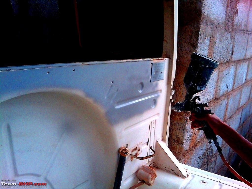

After a long hiatus, work has begun on the Kombi, Focus on getting the shell to be RUST-FREE. The only thing that can aid this is EPOXY PRIMER, got almost 10 litres to spray inside-out.
Some info about the effectiveness of Epoxy Primer.

True Dave, Epoxy Primer must help arrest rusting, An expensive material to use, but its worth every litre.
Total of 8 litres of Epoxy Primer used

There has been few more places where rusting has been bad, that is now almost done.
Body tapping has started, one panel at a time, scrape down to bare metal once again and spray Epoxy Primer before starting Body filler job.
