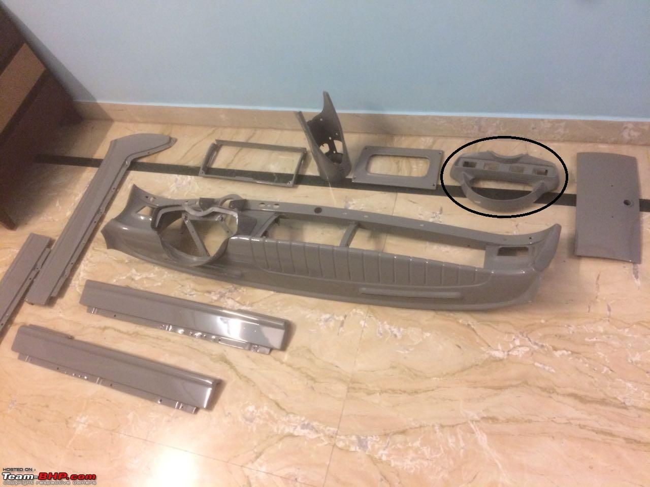

29th November 2016
Like many cars of the period, the interiors of the Vangaurd are not painted in body colour. The original dash colour seems to be a dark grey that was uncovered after dismantling, I assume this is the correct combination.

29th November 2016
Karl, the grey seems to be correct shade from what I remember. Only just check the item I've marked in the following pic. This may have been black.
I am sure the gurus here may know the correct color
Thanks Ram - the problem is there is very little by way of reference image for vanguards to confirm these kinds of details. Can anyone else share similar details? Dungarpur has a Vanguard in unbelievable original condition, though it is an imported Vignale version, so not necessarily the same in many details.
Karl,
May be I was wrong about it. But could find one pic with a Black speedo nacelle as below (but this one is a LHD)

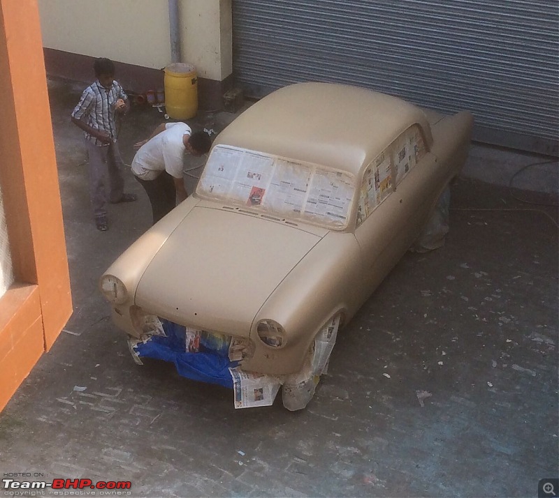

10th December 2016
Final paint process is finally underway.

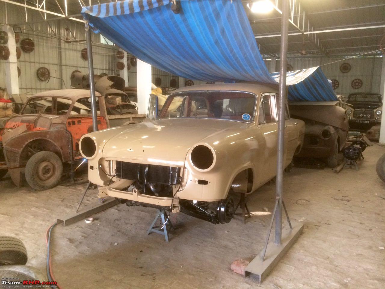

15th December 2016
Car is finally painted, fitting in progress.
