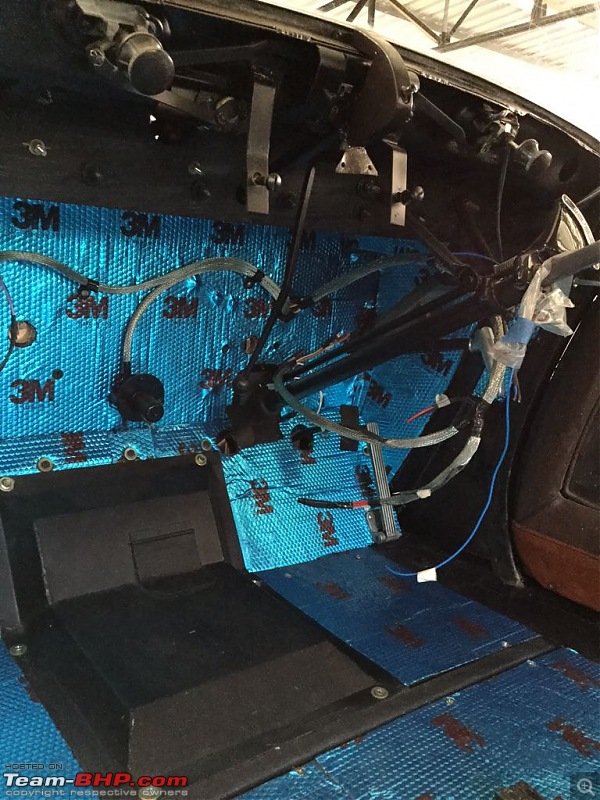

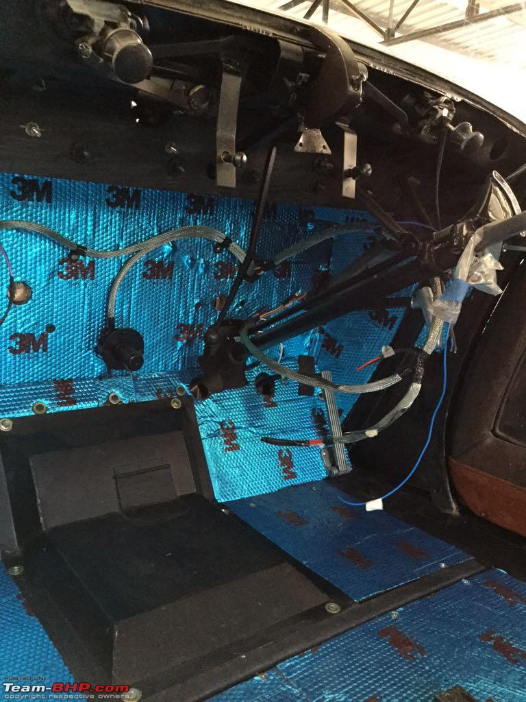

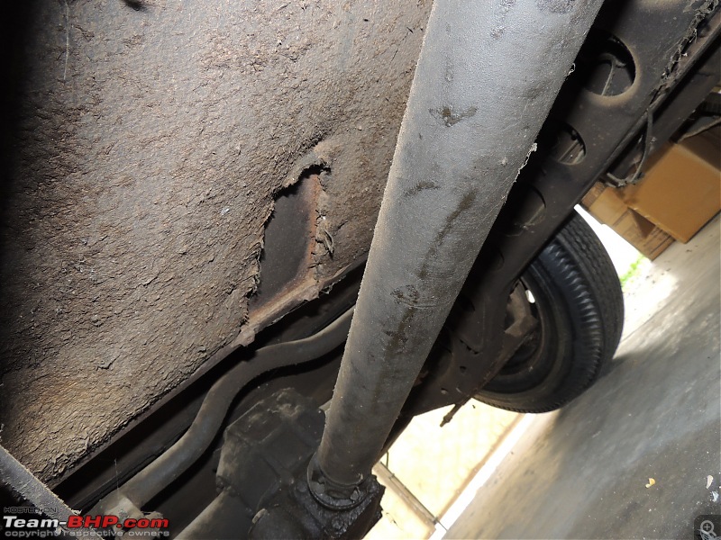

The chassis, suspension and wiring has been completed. The goal is to make the car more safe, reliable and so we have done some practical upgrades.
Seen in the picture is the under chassis. Originally the car came with a sound damper in the under chassis. This was made of cotton wool, jute cloth and tar pitch as a fire retardant. We undid, this as we thought that this was risky to retain.
The completed chassis is seen. Chris takes me through the work done.
We have changed the wiring from positive earth to negative earth. This is a safer option. New wiring was done.

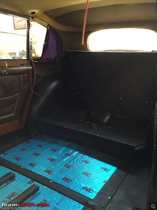

You can also see the 3M material used to retard heat in the cabin and also damp the sound from outside
KPS
Great progress, Would you please elaborate more about the 3M, like the thickness, cost involved and durability etc.
This is basically a Butyl rubber with aluminum product for reduction of Noise, Vibration, Harshness (NVH) in cars, developed by 3M. This is very pliable and takes the shape of the car body for a good tight fit. By the nature of insulation material used, it does reduce the thermal impact too.

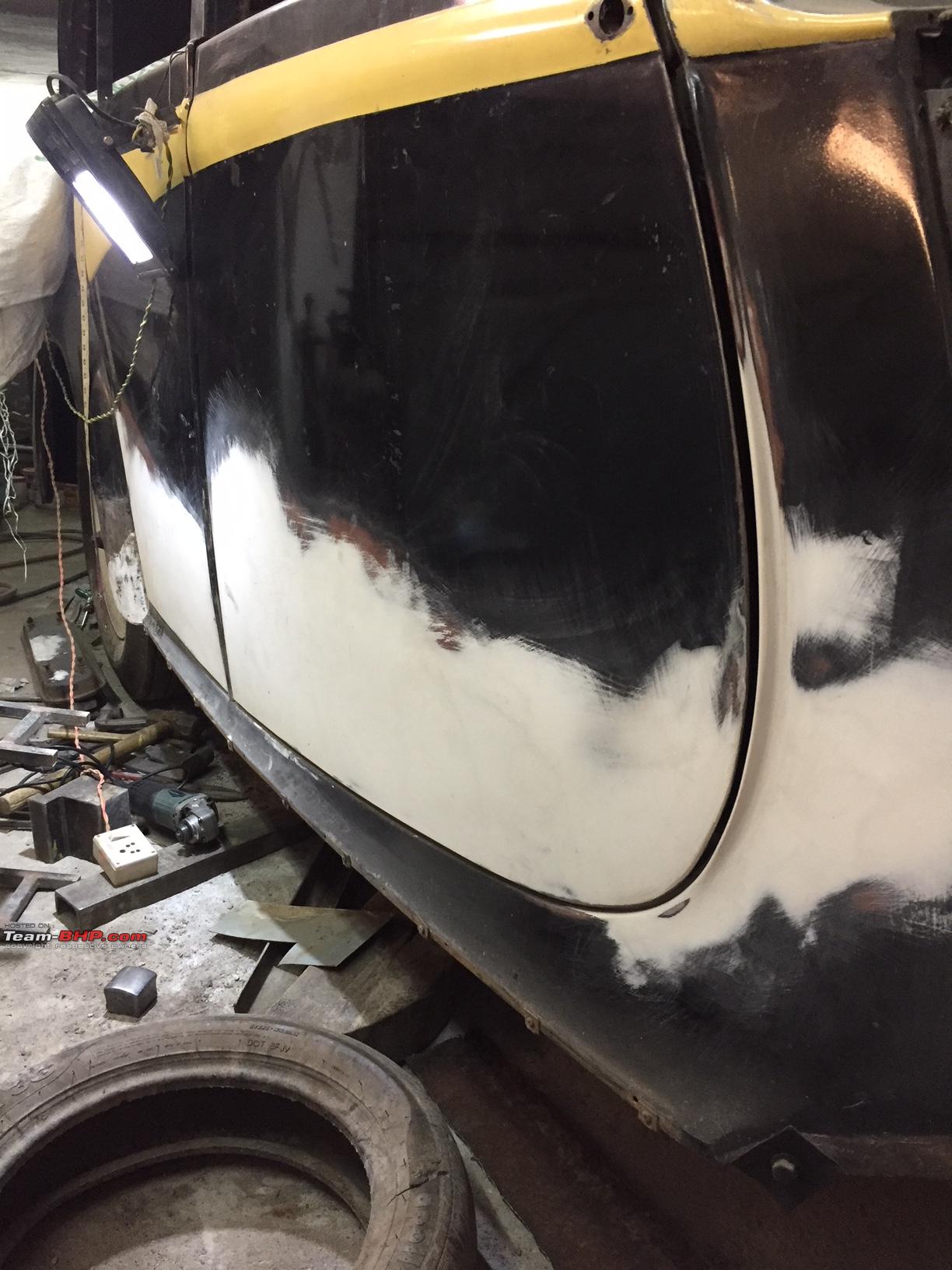

As we wait for the engine parts, we have commenced to tinker the car. The primary focus will be on the alignment of all the panels.
Over the years, the door and window seals had hardened and lost their sealing abilities. This must have lead to water accumulation at the bottom parts, when washing the car or in the rains. Though the rust was very minor in nature, we decided to attend to it with a long term view.
The car was completely stripped and tinker start to work from one section to another.
The front door post tinkering and initial alignment.

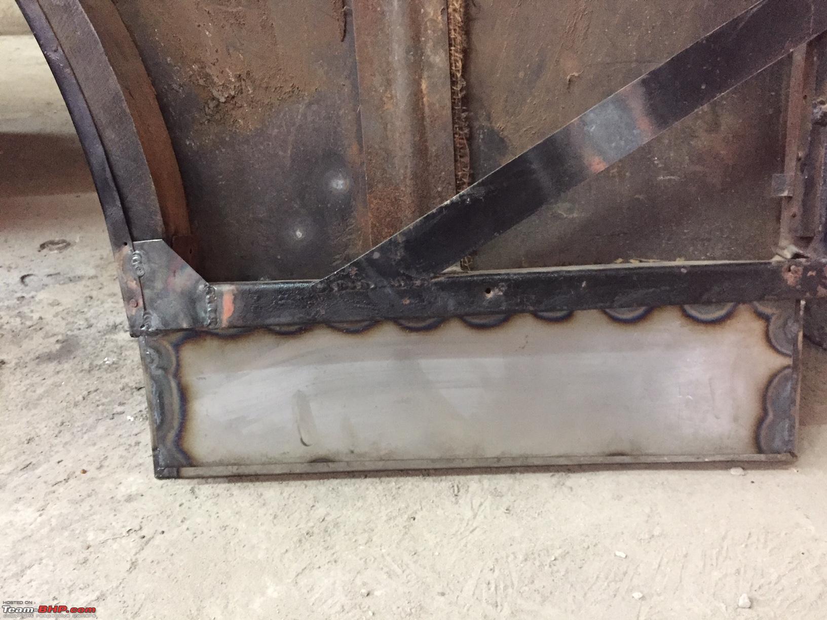

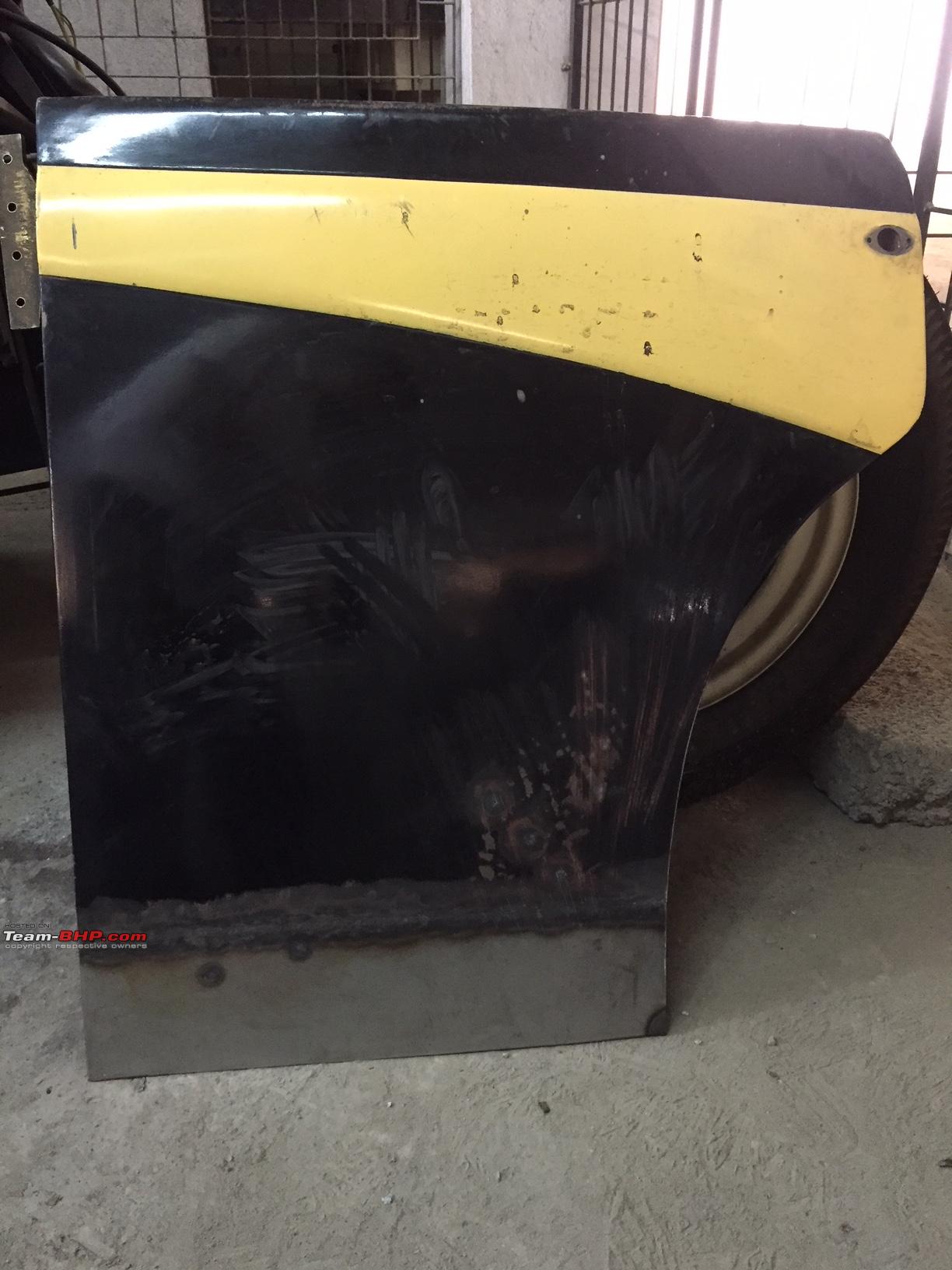

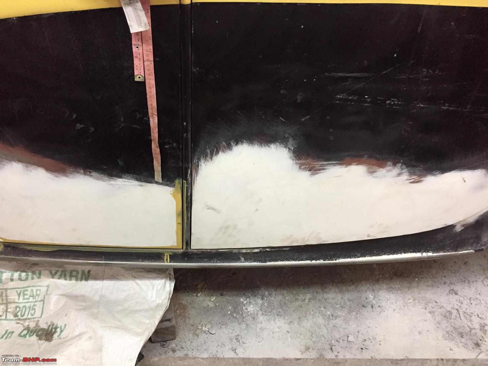

Has been to the workshop yesterday. The tin work is almost coming to an end. The next phase will be assembling all the panels and check out the alignment of complete body. Once this is done, we send the car off to paint.
The rear will always be a mystery. The tinker is very clear that the car has never been rear ended at any point of time. However, the rear glass was plexiglass and we need to tap the boot door a bit, to align. My guess is something must have fallen on the car causing minor damage and breaking its glass. Nothing major though.
However the rear glass is a bit of challenge as it is slightly curved. Hence we are making a mould in fibreglass to cast a new glass for the rear window.
Aligning the panels
The trim under the door was made and fitted for inspection. This is now ready for chrome
