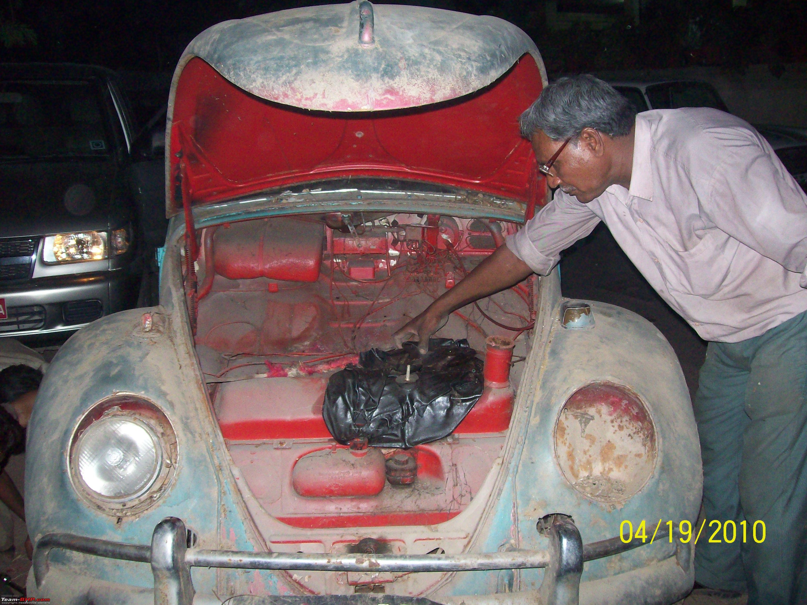

Hi!
I finally laid my hands on a much awaited Beetle Project car. Its a 1966, 1300 cc 6Volt vehicle with an original sunroof, california style bumpers and a genuine radio, left hand drive and original wheel rims on it.
Muuuuuch needs to be done but then thats what project cars are all about.
Requesting Pavan and other Beetle gurus to help me source parts for this vehicle and give general guidance on this project. I love the beetle and this is my first! So help with information, books, manuals, literature and whatever parts that you can.
So here we go

Congratulations Buddy.
Thats indeed a genuine 1966 Bug. I can see lots of positives in this car, its got most of the original fittings,though the engine seems to be in bad shape, would not mind helping you with that.
Dont worry about the fittings, i can arrange them anytime you want.
Get the tinkering and brakes done first, later you can think about the engine and lastly the paint job.
Literature, well, i have some big fat books, presently with Srisha (He's got the same 1966 LHD Bug) will send you copies if needed.
I am excited, best of luck.

Thanks Pavan for your prompt feedback and positive support!
Would definitely love to have a copy of the books that you are mentioning. Do let me know when and how you can help me with that.
The floor is DEAD GONE! So need to do that lot of body work and of course I plan to take the car off its chassis and do a full resurrection in my typical restoration style - Ground Up. Its going to be painfully slow but then thats what is going to give the best results on this bug.
Thanks once again and I look forward to hearing from you on the books.

Congrats Saurabh. This could be a 67 bug. The door handles you have in your bug seems to be those of 67. Remember they were only 1 year model handles. Some models of 67 did come with 6V too. Do share your Chassi no if possible.
67Bug is offline   Reply With Quote
'67 model couldnt have been imported and registered in India in '66 - right?
I have checked the chassis no. and engine nos - they are indeed that of a '66 1300cc VW!

Hmmm...yeah you are perhaps right. Maybe the door handles are not original in that case !! But overall a neat bug and has most of the rare body parts in it which in most cases people struggle to procure. Liked the radio. Any closer snaps of the same?
