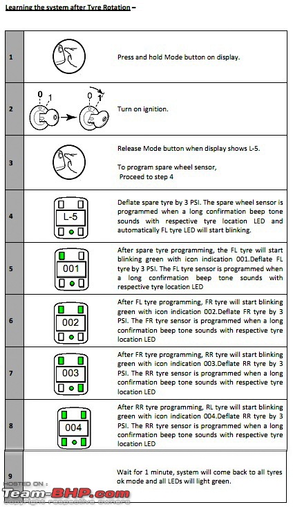

Originally Posted by sach.sri View Post
What is this L5 reset - and how can it be done? Can i do it myself or will i have to goto the A.S.S for getting it done?
The precise details of how to perform L-5, after tyre rotation or otherwise.
This whole gizmo is highly inaccurate, I dont trust the Scorpios tyre pressure system at all, a pretty worthless exercise if indulged in I would say.
The offset is as high as 5 to 6 psi at any given time. And that's a lot.
desertfox is offline   Reply With Quote
I do find it very useful, without relying on accuracy. It does tell my if any tyre is loosing air, without having to indulge in a routine air-fill exercise to bring about the bad news (as is with my other cars).
Besides this, in somecases, I can time my tyre repair based on how much the tyre in question is loosing over a day or period.
One more thing, this TPMS had indicated full tyre blow out in offroad condition, which I would have not found out easily given that the soil was soft and I was anyway running deflated.
So accuracy apart, TPMS is definitely a boon.
1100D is offline   (2) Thanks Reply With Quote
