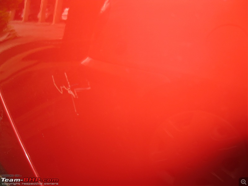

Originally Posted by biyer View Post
Disclaimer: This is not a recommended solution for any and every scratch. .....
If its a deep 6-layer scratch then buy a matching colored nail polish ...
Works best on light colors. Works really poor in red and black.
Thanks for your tips biyer. As it turns out, I have a red car.
I am posting some pics of those scratches caused by vandals here.
These scratches is actually not as superficial as the pictures make them look. This one runs from the rear tail lamp to the front door.
Somebody tried to inscribe something. Makes me think it was a kid ?
Sorry to hear that buddy, I am going with same pain. But as you are having non metallic, brush touchup will help. As nothing else than repaint would work so do not waste your time. You have only two options:
1. Live with it or get brush touch up.
2. Repaint.

[quote=sajo;2467837]Thanks for your tips biyer. As it turns out, I have a red car.
My black metallic figo has faced the same problem. Someone sick low life marked the hood of the car with 2 deep lines/scratches.
The local shops and smaller paint shops told me rubbing wont help as the marks are too deep.
Back home I used a strong rubbing compound with a orbital buffer and finished it off with a sealant and then good quality wax. The scratch is still there but you can not make it out unless you inspect the area carefully.
This is the best way according to me. A brush touch up will spoil the look. And a paint job is very expensive.
