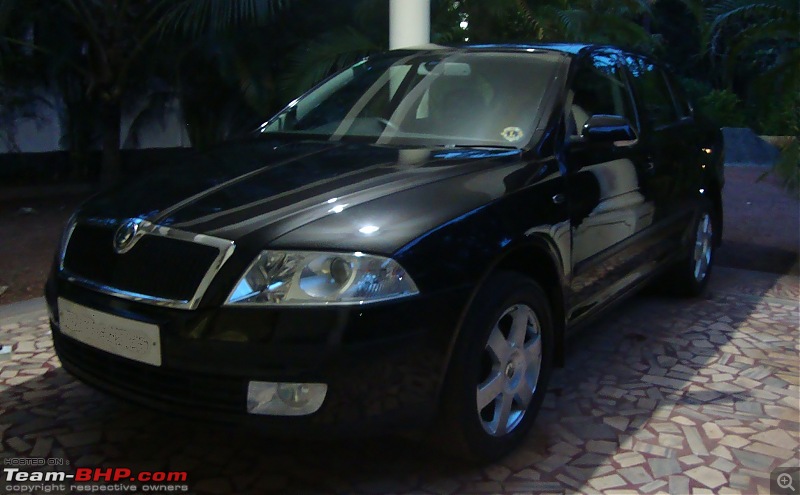

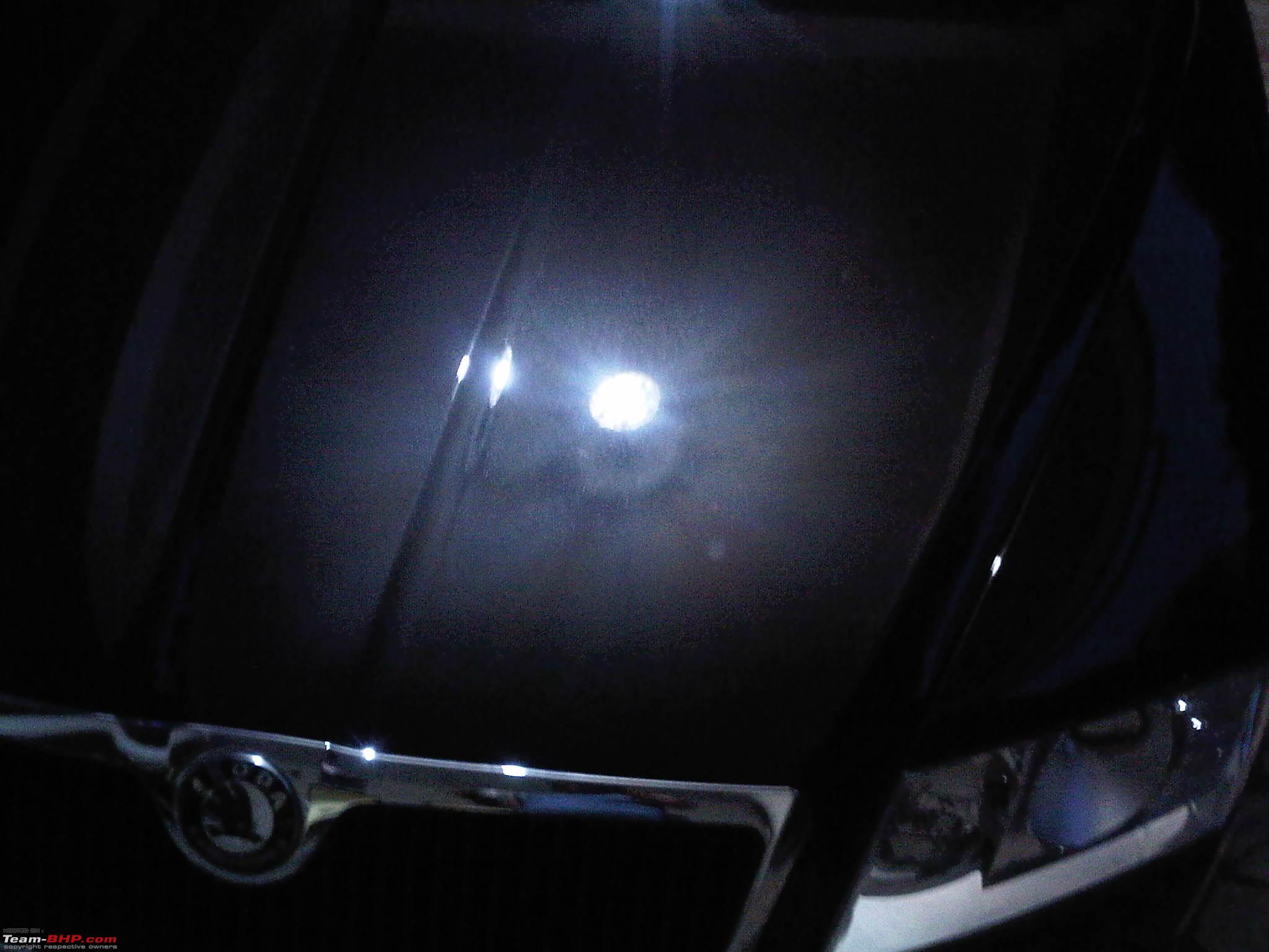

I was going through this thread for some time and like all car freaks i also wanted my car to be shiny all time. Me an My friend did lot of research and sourced all the required products one by one from US and UK (Thanks to all our friends and relatives abroad). We got the products in a good deal from Amazon, CG website, Ebay, detailed image and Autozone. I have a White Fiesta and Golden silver Alto, my friend have a Black laura. My cars are comparatively new and better taken care so we decided to start with Laura with the following inventory.
1. Lake country 6" Pads ( Wool, Orange, white and Blue)
2. Meguire"s ultracut 95
3. Menzerna Powerfinish
4. Menzerna Superfinish
5. Chemical Guys M- seal
6. Chemical Guys wet mirror finish
7. CG Back to black
8.CG citrus degreaser
9. Tarex Tarminator
10.3m Masking tapes of different sizes
along with locally bought Cyclo tyre dressing foam, Sonax cockpit polish and a bottle of Colin glass cleaner. Sourced a rotary polisher locally for Rs.3700/-.
The Laura was full of swirl marks and minor scratches especially on bonnet front fenders and front doors. Step by step process follows
1. Removed all tar spots, tree saps and bird drops residue with Tarminator and Clay bar( already had) and washed with sonax car wash and CG citrus degreaser ( alloy wheels) .
2 We did some wet sanding with 3m 1500 grit on medium scratches after masking all beading and lights.
3. Removed large Swirls and sanding marks with Meguire’s ultracut 95 on Purple wool pad. by the end of this step itself we became confident on using Rotary polisher.
4. Polished the entire car with Menzerna Powerfinish on Orange pads. Man it’s a heavy task! You need to be really patient for getting use to the rotary ! but the results were soothing .
5. Polished again with Menzerna superfinish on Blue pad with out any pressure. But we were really tired for the day! But decided to finish the next step also
6. Applied a coat of CG M- seal by hand and waited for 20- to 30 mts. ( Read time for a beer!) and then rubbed it off with white microfiber cloth. Man… the its unbelievable… we have a new car in front of us!
7. Next day after one more coat of M- seal applied 2 coats of Wet mirror finish.
8. Removed all masking and cleaned all fiber beading with CG Back to black.
9. Cleaned the interior with a vacuum cleaner and 1” general purpose painting brush.
10. Dressed the dash board, door pads and other fiber parts with sonax cockpit polish
Finally a Saturday and Sunday used very productively and satisfactorily!!. Pictures says it all..
Money shot!
No swirls !
Next time step by step photos will follow.
Did not use any wax so far. Will wait for the monsoon to subside. I am not happy with the “so called” Wet mirror finish of CG. Let me see the effects of it on a white surface also for a final verdict on it.
Next weakend , its time for my Diamond white Fiesta to get a spa treatment! Man I am going to have heavy biceps !!
Chears!
toms_2191 is offline   (2) Thanks Reply With Quote
