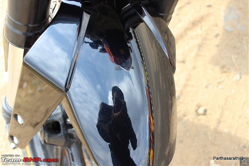

Today managed to get on with my 1st proper detailing session on the Duke, after struggling to acquire the products from Meguiars, plus the various brushes and towels. Finally, Mr. Nirmal came through with all the products that I needed.
Stuff that I acquired :-
1. Meguiars Clay bar kit
2. Meguiars Gold Class Foam pads
3. Meguiars All Purpose Cleaner
4. Meguiars Hyper Dresser
5. Wolfgang Deep Gloss Sealant
6. Motomax 2k rubbing compound.
7. Iso Propyl Alcohol
8. Paintbrush
9. Bottle brush
10. Cloth's brush
11. Jopasu Magic wipe
12. 3m mf cloths
13. Formula 1 car wash and wax
14. Nevr Dull wadding metal polish
So here's how I got the bike cleaned and detailed today:-
  • Hose down the bike.
  • Clean with car shampoo
  • Rinse
  • Apply APC to nooks and crannies along with the brushes, to remove the accumulated dirt and grime.
  • Rinse.
  • Dry with Jopasu Magic wipe mf towels.
  • Clay + Lube till the surface became slick.
  • Dry again with the mf towel
  • Compound with Motomax 2k
  • Buff off once it hazes.
  • IPA wipedown - thought of doing this initially, but completely forgot about it in the heat of the moment.
    In hindsight, it was good to leave out the IPA, since being a beginner, I could've easily marred the finish due to improper dilutions.
  • Apply Wolfgang Deep Gloss Paint sealant using the Megs applicator pad. Wait for half an hour before removing the product.
  • Meanwhile, Apply Hyperdresser to plastics and rubber. I used it in 1:4 dilution to obtain a satin finish.
  • Nevr-Dull wadding polish on the copper, chrome and brass parts - exhaust header pipes and on the end can.
  • Buff it off.
  • Now after 35 minutes, the paint sealant had hazed. Checked the hazing with the swipe test as described by Mike Phillips. Once satisfied with the result, buffed off the product.
  • End result.
    Reflections

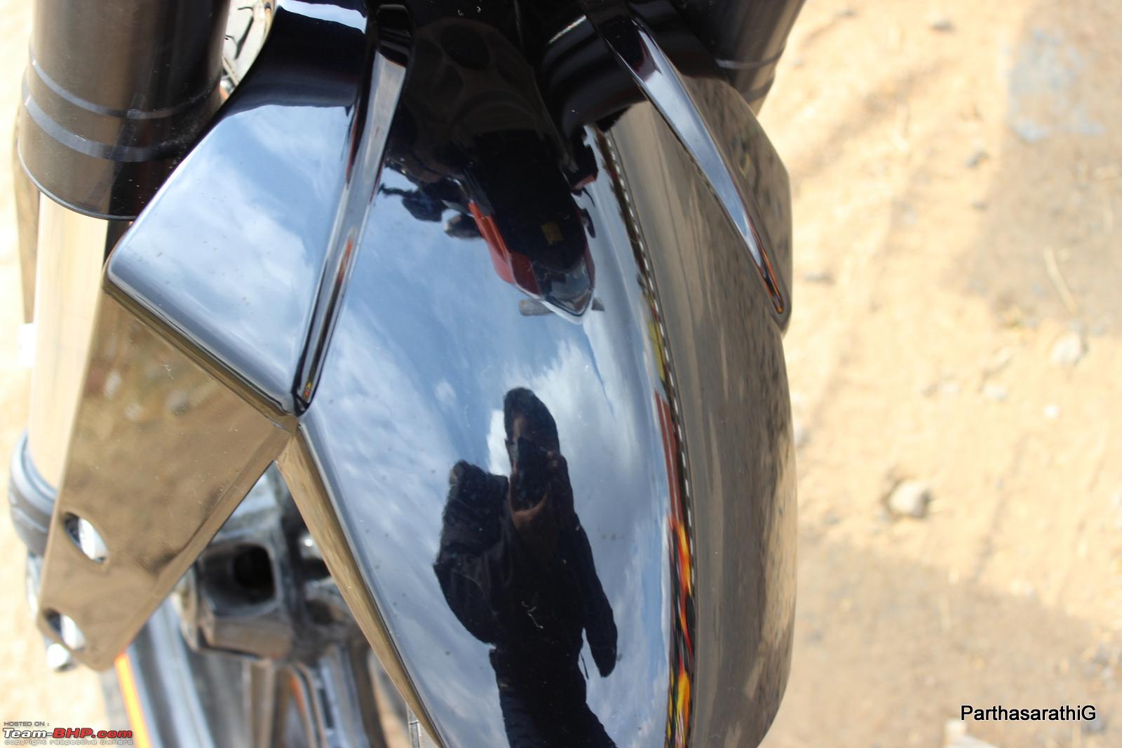

Some more pictures in the sun. Almost 24 hours after curing of the sealant. Im happy with the overall improvement. Now it looks better than it was out of the showroom. I can even see the clouds, myself on the tank while riding. Earlier all these were not so clear.
Now Im thinking how to maintain this finish for atleast a month. Typically in Bangalore's conditions how long would a sealant last? Also how does one figure out when the sealant's protection has decreased? Should I also give a second coat?
@sushrutha I followed the same procedure almost. Forgot some in the heat of the moment. What polish could I use? How good is Meguiars?
