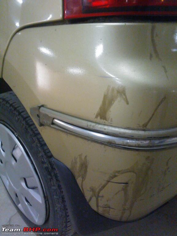

Hello All,
The bumper of our car has some hard-thick stain. I noticed it couple of days back, the stain resembles mud.I did not bother to check it as its monsoon time and i was convinced its mud. Today in the morning after the cleaner washed the car.The stain is there, dried.
Its from the boot opening on the LHS on the bumper till the mud flaps. When i opened the boot ,i could smell egg
I do not know how it happened,but it appears ugly. What should i buy/do to clear this stain.
Need Advice.
Rishi
A picture for reference:

try to wash it with good shampoo , if it doesnt go then use Rubbing compound.

Use a light concentration of household vinegar, maybe 20%. If it doesn't help, you can try IPA (Isopropyl Alcohol)
