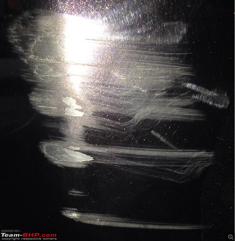

There are instances where the cars brushes some other vehicle and the other vehicles paint is sticked to the body. There is no dent or scratches, but just the other vehicles paint sticking to the body. Like say, my car brushed the auto and I can see the yellow color paint streaks on my bumper. If I immediately clean it off using a cloth, some mild paint residue comes off. But the others remain.
Also I brushed my car to a small tree trunk when reversing my car. It was so dar, the trunk was completely hidden. This has left my car with scratches. How do I remove it or just lighten it.

If you are very sure that the paint from the foreign object is on your car and your car hasn't lost any paint in the transaction, you can use a polish ( light ) or a compound ( strong ) to remove the paint from the surface. Just rubbing it with a cloth to remove it may cause additional surface level sctratches! So do not do that.
But as for the tree trunk, I am pretty sure that your vehicle's paint has been rubbed off, so you may not be able to remove the scratches completely, but can mak them using a polish with fillers to get the job done.
But I would recommend you to get the surface painted again ASAP, as you may leave behind exposed metal and rusting may creep in pretty soon. Please share pictures for the experts here to understand the condition better.

I am sure my cars paint are not lost. When you say polish or compound, which one do you recommend. Unfortunately for this i dont have a snap.
Polish with fillers? Can you recommend anything particular. I am not sure whether my cars paint is dislodged. Please have a look at the pics and suggest.
With flash
A superb Car cleaning, polishing & detailing guide-imageuploadedbyteambhp1390973184.927737.jpg
Without flash
A superb Car cleaning, polishing & detailing guide-imageuploadedbyteambhp1390973207.878793.jpg

If the pictures are of your car, you have indeed lost paint. I presume the shot is of a bumper - as black plastic is visible below if I am not wrong.

Looking at the pics, paint is lost at certain areas and there are fines white lines all around. Since your car is of black color, no point of painting it as black bumper would gel well.
As for those white lines, they can be taken care by using a compound. I would suggest you to get Meguiars Ultimate Compound and a yellow pad for applying it. Use it and those white lines would disappear and it would leave a nice smooth surface.
Others may say Ultimate Compound may be too aggressive, buts its not. Its very safe to use by hand or even a DA. It leaves a brilliant smooth surface & shine. Get it and you wont regret it.
You can source it from Bringing Best Impex or can even try Ultimate Detailerz.

My car color is not black. Its kinda purple shine. I need to closely examine if indeed those black areas are where the paint has peeled off. BTW, if the white lines go off using the compound, i will right away order one.
Yes its the rear bumper. There is no plastic beading there. Its my City.
Now i deeply regret for not having a rear sensor. Its time to purchase one.
