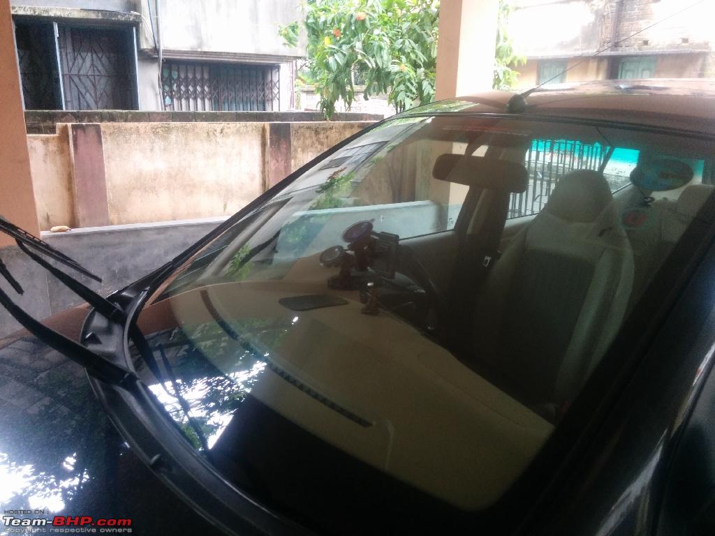

Some WIP pictures:
Look at the unsightly wiper marks!
After polishing was completed
Done with applying Flyby30
Tools used - Kestrel DAS 6 power+ with 5" backing plate holding a carpro glass rayon pad, B&D heat gun, and spray bottle containing plain distilled water (ignore the 11% IPA sticker).

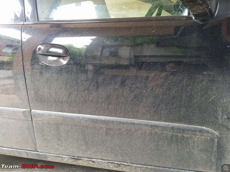

Before spraying:
Let it dwell for 5 minutes and then pressure rinsed - most of the dirt just washed away, and pieces of muck fell off like they were being pushed off!
