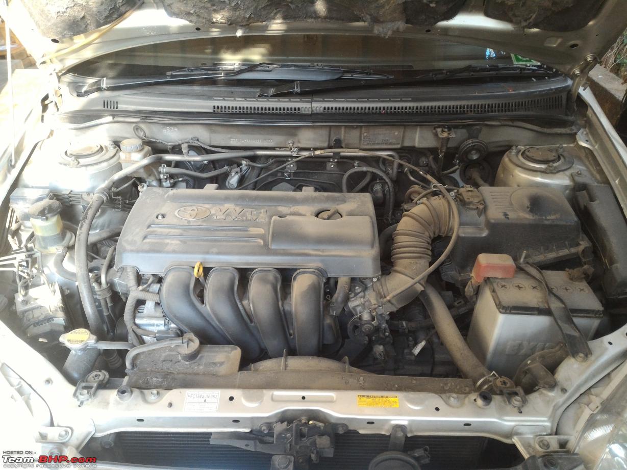

HOW TO DO ENGINE BAY CLEANING
Engine bay is one part of the car which most of us neglect to take care of regularly (including me ]) for various reasons, (1) it is comparatively difficult to do engine bay cleaning than any other part of the car, (2) it is risky as well, (3) and most important reason we neglect it because, there is nobody to peep into your engine compartment and appreciate your hard work .
Till now, I had not even cleaned my engine bay once and my itch to clean the engine bay took off after seeing the dirt accumulated under the hood.
Still, I was quite skeptical of doing it, since the engine bay has lots of sensitive inlets and electrical parts and I had read some horror stories on the after effects of engine bay cleaning using power wash. So, I was in search of a waterless and an effective way of engine bay cleaning with minimal effort, and there is none other than Mike Phillips to help in these circumstances.
I came across two threads (and much more infact) in AGO forum written by Mike Phillips on the engine bay cleaning.
More detailed and traditional way of engine cleaning here:
How to clean an engine compartment
Quick, refined and effortless way of engine cleaning here: - This is called Cosmetic Engine Detailing:
How to do cosmetic engine detailing
I was actually interested in following the Cosmetic Engine Detailing method with some small modifications, given the products what I have. Below is what I did:
1. Dust off using a big brush and using toothbrush for areas where big brush cannot reach - In this step, I was able to dust off most of the fine dust and engine was looking quite good after the 1st step itself.
2. Using the toothbrush applied and agitated the parts with Autofresh APC (I did not spray diluted APC directly on the engine bay, but sprayed on the toothbrush and applied). Note that, APC generates more foam even in the diluted form compared to any of the waterless wash products, hence I preferred using APC. One may even try with waterless wash also.
In this step, while cleaning with the toothbrush using APC I also simultaneously wiped off the APC concentrate so as to take out the dust. If you only use brush continuously without wiping it off with a cloth, the APC may get dried on the surface and would be difficult to clean later.
3. Clean with another clean cloth / MF cloth and use APC if required as a lubricant. This step would help in further removing the dust using a new cloth.
4. Once I felt that the compartment is clean enough, I applied Vista Dash Board Polish on the plastic parts (I did not spray directly on the parts, but sprayed on a MF cloth and spread even on the plastic parts). One may even use any Tire & Trip Polish / Protectant for this purpose.
5. After leaving to haze for 5 mins, buffed the dash board polish to give a shine.
Note that, my intention was not to clean the engine compartment to make it as new (this is only possible in a detailed way of engine bay cleaning using engine degreasers, power wash, where you have to be extra careful of covering all the parts where you do not want the water to enter). My intention was only to clean wherever the brush / cloth / hand can reach and aim was to clean 70% of the compartment with minimal effort. Guess I took around half hour to do this exercise and may be even less the next time around.
I would be happy if anybody can highlight what best can be done to clean the balance portion of the compartment without using power wash.
Here comes the most important part of the post, the Before and After pics:
Pics here - Hope you can easily identify the before and after ones.
