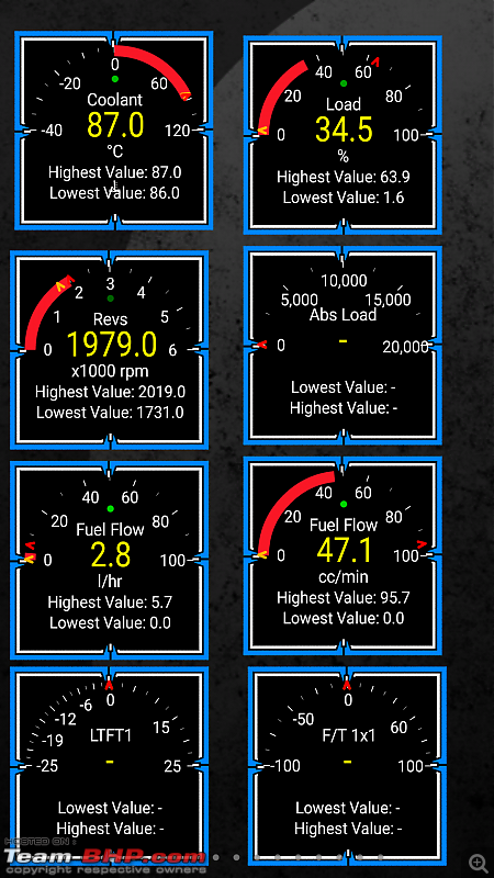

Default Re: Does coasting save fuel?
Originally Posted by arunmichael View Post
Now from what i understand from this thread, the fuel supply is cut off as soon as driver takes his foot off the accelerator pedal. If that is the case then i am definitely wrong. But why do we still hear the engine grunt if its not working?
Hey, to get you clear your confusion, I used Torque App and OBD reader to get the data from the ECU. Here you go:
Fuel flow at 80 kmph:

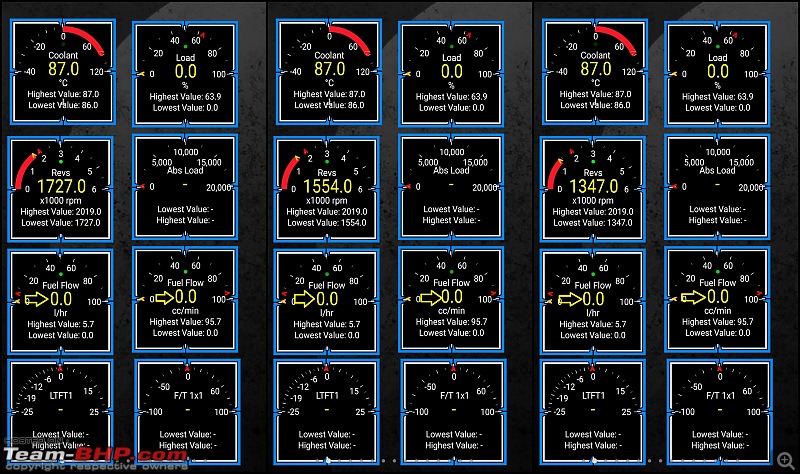

Coasting in Neutral (Note the yellow arrow in the fuel flow tab):
Coasting in Gear (Note the yellow arrow in the fuel flow tab):

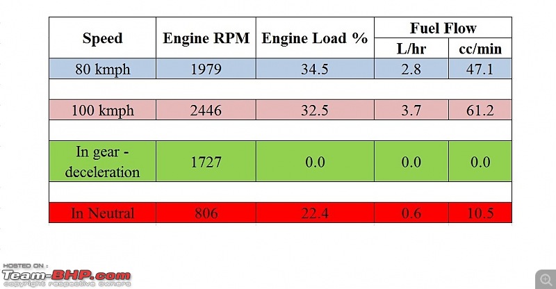

In this I have attached three consecutive shots to show the deceleration (Notice the RPM dropping) but the fuel flow is '0'). Engine load too is 0.
To summarize:
a4anurag is online now   (9) Thanks Reply With Quote
