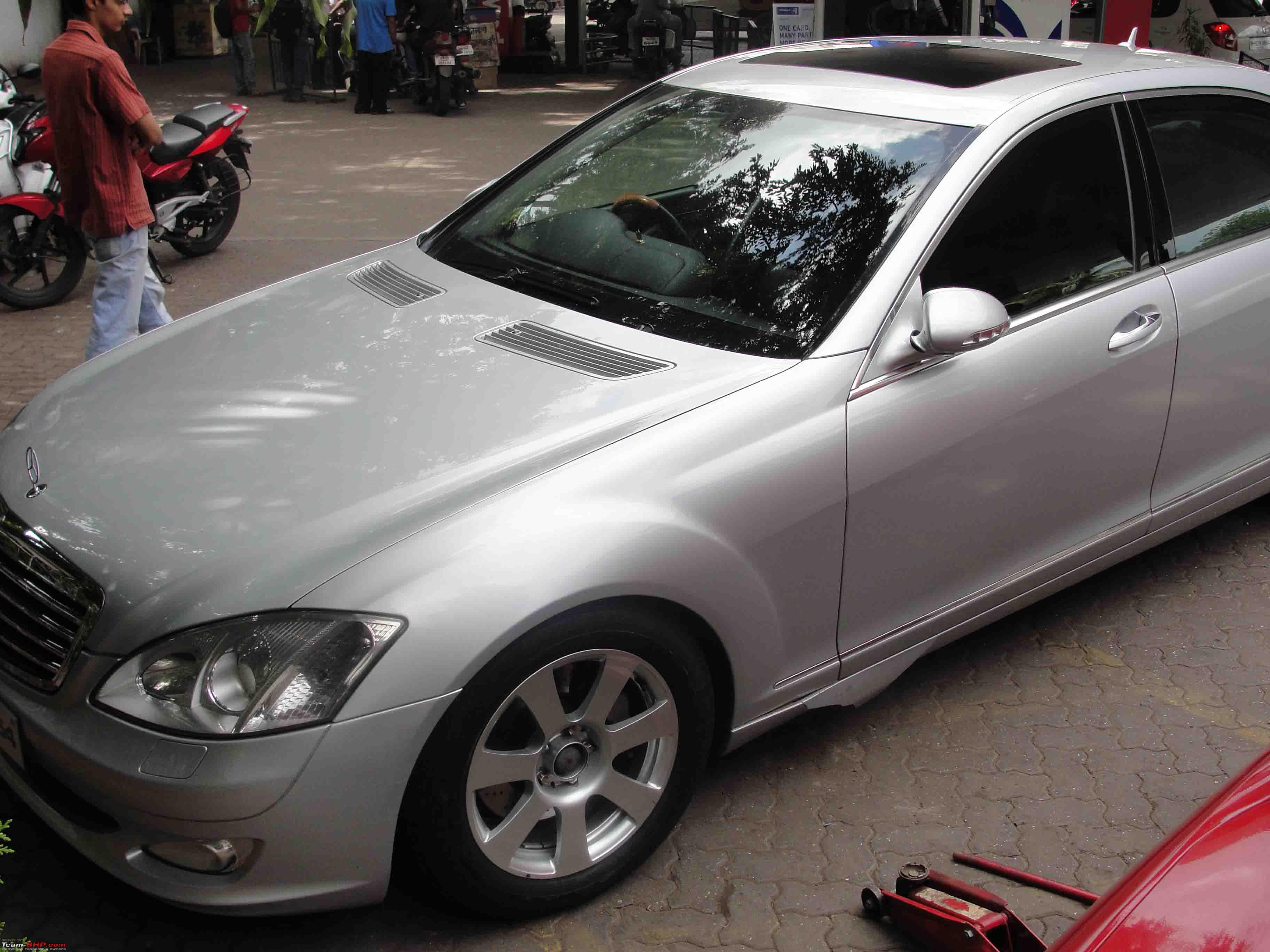

This occured about 2 days back at the Mhasoba gate petrol pump, Pune. A Mercedes S-Class was jacked up to repair the punctured front left tyre. The driver of the car and the puncture guy had their collective efforts in jacking up the car. They used the jack provided by Merc. The wheel was removed after which the jack slipped and the car came down with a thud. The underbody and the disk were resting on the ground.
After a few moments of silence there was a lot of commotion. Now the mechanic couldn't find a place to apply the jack again but he managed eventually. The fibre skirts of the car were damaged and there were a few scratches on the bumper. I cant say what was the effect on the suspension and disk allignment. Looked unharmed. No one was injured in the accident.
The wheel was replaced and an arguement between the driver and petrol pump authorities followed with both blaming each other. Both of them were visibly frightened.
It seems that there is a need of a thread demonstrating proper techniques for using the jack so that we can avoid such incidences.

1: Did they use the correct jacking point?
2: Was the transmission in Park mode and handbrake activated?
3: Was the ground uneven?
I wold consider these issues before making an inference

It almost appears the Jack was mounted on the sides of the car than the actual mount point which has a slightly different texture(solidity) with a groove for that jack to sit.
Also crashing down and breaking the side skirts does look like the job of the Jacks positioning and not from the crash itself.
But i may be wrong. . I just drove down to coimbatore. Just before the drive i tested the jack at home, removed the wheels and re-mounted to make sure i am aware of doing things. I feel a little practice could have atleast warned a bit.
THats one costly affair to get it fixed hoping the disk brakes are fine as per MERC mechanics

The only way this could have happened is the handbrake not deployed, right?
I don't know about the jack Merc provides but the ones I've used with Maruti and Opel, they are built in such a way that they wouldn't topple easily. Something like an arch on both sides.
So, it would take a good push to topple it off the jack.
Without doubt, placement of the jack is important; not just to avoid this but also to ensure the load of the car is balanced on the right point.
OT : is the side-skirting made of fibre? Shouldn't it be metal?

There is a slot under the car where you slip the top of the jack in so that it doesn't slip.

I fail to understand why they used the jack provided by Mercedes when they had a 'crocodile' jack available.
Out of curiosity, how would you jack up a car that is resting on its underbody and discs?
The proper manner of using a jack is to ensure that the vehicle is on level ground, the gear is set to park (for AT) or neutral (for MT), the handbrake is set, and if the vehicle is parked on loose soil, place some rocks on either side of the tyres (except the one to be changed) to prevent any movement. The jacking point for vehicles can differ (esp. very old vehicles) therefore refer to the owner's manual to find the jacking point. Always loosen the nuts before raising the vehicle with the jack.

Also a spare wheel was not put under the car when it was jacked up .It would have prevented this .

Looks like a case of jack mounted at wrong spot. The jack mounting points are clearly mentioned in owner's manual of most cars. The guys at at these tire repair shops do not know/care about proper mounting points, they just look at the underbody to find a safe spot and mount the jack.
