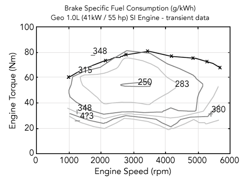

Attached is the Specific Fuel Consumption Graph for an engine (Source: internet).
It shows that the Fuel Consumption is least at the curve 250 that lies on either side of 3000 rpm.
Now the Gear Ratios for this engine will be decided at this particular engine speed range. Max torque and speed is tuned at this engine rpm rate only.
Thus engine speed (RPM) is a direct function related to the Fuel economy.
