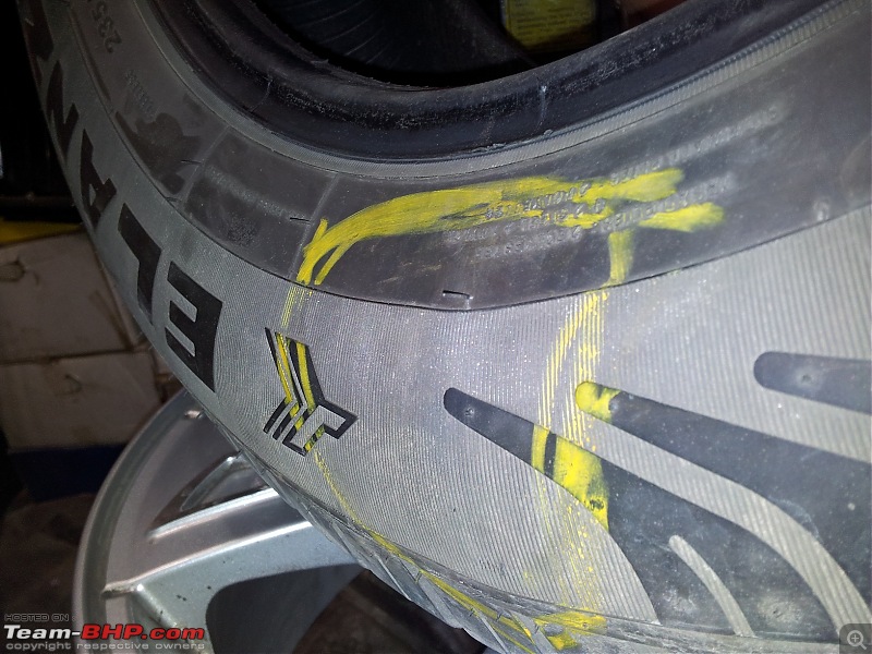

Hello fellow XUV owners. Yesterday my TPMS showed that the tyre pressure was low I straight away went to the local tyre shop and saw that there was a bulge on the outer side wall of the JKs. I imidiately called up my RM and went to meet JK representative who initially refused to provide warranty as he said that there was a crack from the inside of the tyre. I persuaded to get it replaced and after shelling about Rs. 1800 I was issued a new tyre. I remember mannubhai too had some problem with the JKs.
The tyre shop at karol bagh also told me that the situation will worsen in summers as the JK tyres are hard and are more prone to cracks. So the suggestion to fellow members who are yet to take deliveries is to avoid JKs at any cost.
EDIT: Added pics of the cut and the bulge

The tyre shop at karol bagh also told me that the situation will worsen in summers as the JK tyres are hard and are more prone to cracks. So the suggestion to fellow members who are yet to take deliveries is to avoid JKs at any cost. EDIT: Added pics of the cut and the bulge
Why would you even have to pay Rs. 1800 ? It should be covered under warrenty.
And yes avoid JK's at all costs, even Scorpio with JK has similar problems.
I guess you are the lucky few who got properly QC'd vehicles
It's because I have driven it for more than 10,000 km and they say that I will have to pay for 20% of the actual cost of tyre because of that. The initial figure was for 30% but I negotiated and got it down to 20%.
In that case it is palatable that you paid
