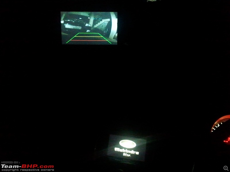

Hey guys i have this problem with my xuv. couple of times it has failed to start. I then removed the key and waited for a min and tried again and it started. anyone else have this problem with their xuv and any idea about the cause of this problem and solution
I have installed the rear view camera but there is 1 problem with the display. when i start the XUV the entertainment system starts booting and takes some time to display the rear view camera so i have to wait at least 30 secs before i can start reversing the XUV. I had a lcd rear view camera lying around from my magnum so i got a local accessory installer to fix in on my XUV by connecting it to the av cable from the rear view camera and the reverse light wire so now i have instantaneous rear view display when i want to reverse.
In the photo below you can see the rear view in the lcd rear view mirror in my xuv while mahindra is still rising in the entertainment system in the bottom portion of the photo.
Hello,
Please refer to my post here, had the same issue:
http://www.team-bhp.com/forum/offici...eview-149.html (Mahindra XUV500 : Test Drive & Review)
Post from 10th April, 2012.
