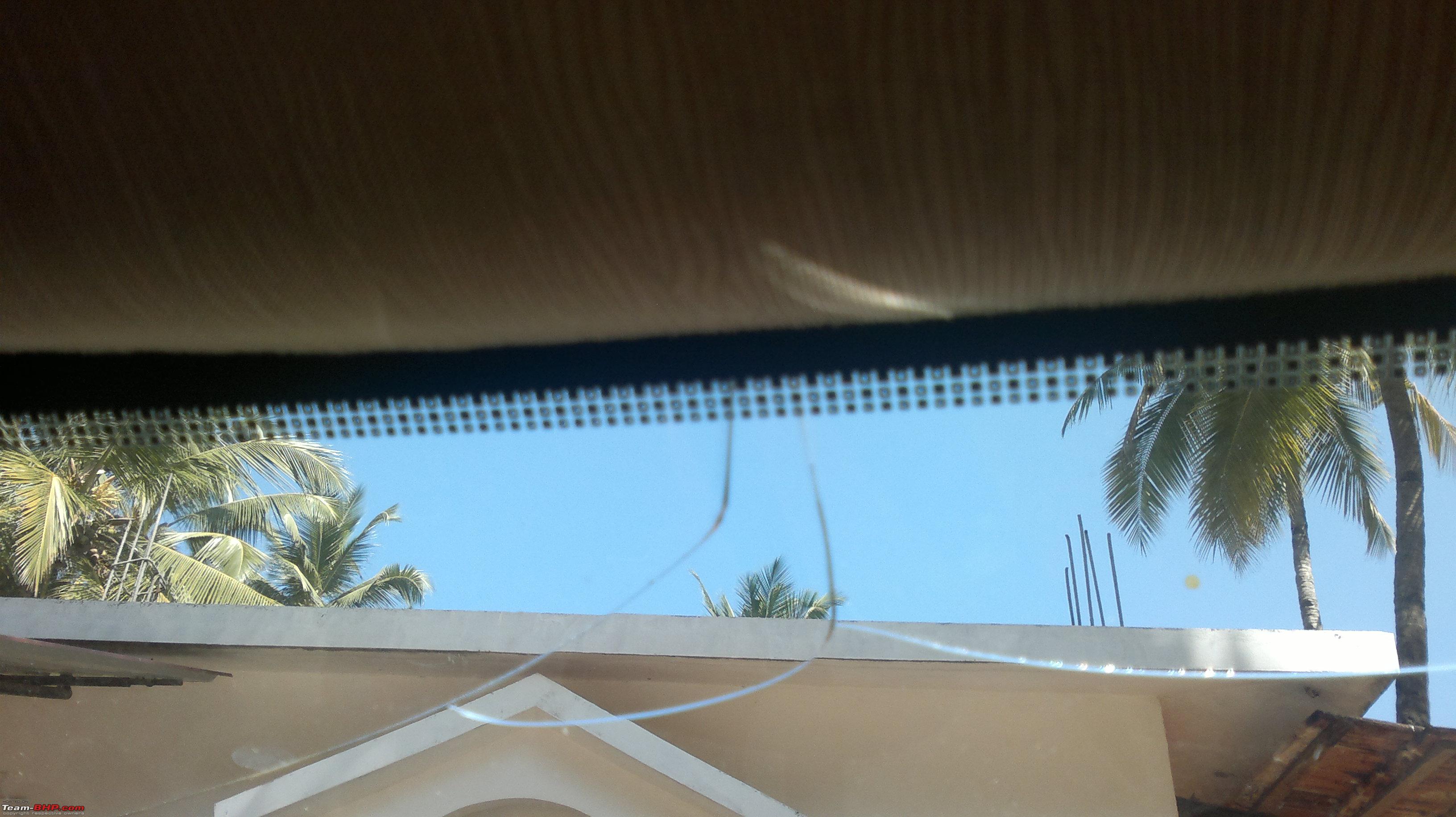

Anyone seen their XUV front windsheild crack due to heat generated by vehicle parked in sun for long hours?
I happen to be on the move and my XUV windsheild has craked all of a sudden on the car that was parked. The temp during the day peaks at 44 degrees. So thinking if it could be a cause since there are no spots of impact caused by pebbles or stones (see pic for reference)z
