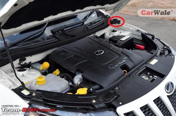

My XUV is a month old and has run 1500 KMs and everything is fine so far. I'm facing a wierd issue for the last one week. I have noticed that once I park over night, there are bits and pieces of sponge lying under the sump gaurd. The first time I did not take it seriously but I noticed it thrice. I have posted some pictures. I did get under the car and when I put my hand inside the sump guard I noticed this is the padding inside that is shredding. What is wierd is that this seems to be accumulated like some one assembled it below the sump guard and why is this shedding overnight? What happens after the car is parked. Is it the heat from the engine.It is almost like some one put their hand inside the sump guard and pulls the sponge pieces out. Has anyone ever faced this before?

Originally Posted by fiery enzyme View Post
Hi Guys,
Looks like rats are chewing the Cheetah. The sponge could be the sound deadening layer inside the engine guard plastic cover. Probably one thing you can immediately try is have some tobacco tied inside the engine guard.
...What happens after the car is parked. Is it the heat from the engine.It is almost like some one put their hand inside the sump guard and pulls the sponge pieces out. Has anyone ever faced this before?
Agree with HCP. Does look like rat-problem.
From the pics, it looks like the rats are nibbling on the rubber piece (marked in red circle in the below pic) that is at the near-corners of the engine bay.
Name:  xuv engine bay.jpg
Please pop open the hood and inspect the rubber pieces on either side. I have had this issue in the past. Keeping the parking place clean (clearing away anything that could attract rats) is the only long-term solution.
Our XUV has this exact rubber piece shown in red circle in that pic chewed by rats. Half of that rubber piece is now stuck with the bonnet hood rather than the body. Stuck tobbaco puches at 4 different places inside the engine bay !

Bingo! That was the problem. Those rubber pieces from the picture have been chewed by rats however it cannot account for so much of sponge pieces. The RM feels the rat could chewing the sponge lining below the carpet in the floor area ( don't if there is even a lining there). Tomorrow I'm taking the car to the ASC and put it on the ramp to see the damage.

The SA i met today told me this is a common problem with the XUV 500 and that he can do something to prevent the rats from getting in. Will know tomorrow.
What is with XUV and rats. If they have a solution that should have been put in place already and not when someone complains.

Mahindra has a mesh to prevent rats in the XUV. Get it fitted. It costs less than Rs. 200, I guess. These are some 3-4 pieces of mesh which are fitted just under the black cowl (meeting point of front windshield and bonnet)

The mesh stops entry of rats in the main cabin. The engine bay is pretty much still accessible to them and that's where the impacted rubber-piece is located in this case.
