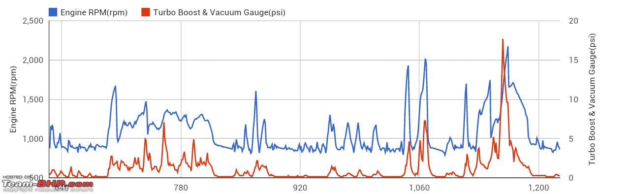

Originally Posted by onyxgaze View Post
Hi,
I just started using torque pro with an obd2 dongle in my Xuv.
Could you advise what finally happened with your diagnosis of the Xuv turbo.
Looks like I am also reading a low turbo boost pressure.
Thanks in advance.
I thought I had posted updates here, but looks like I didn't. Sorry about that.
The analysis of the graphs by mahindra's R&D through my personal contacts was that the solenoid valve was the issue. Either the valve itself or its driver. But it was hard convincing the service center about it. They insisted on their own diagnosis and said that the turbo had to be replaced. Well, I didn't mind getting a new turbo though I wasn't convinced it will solve the problem, so told them to go ahead. After replacing the turbo didn't feel any significant improvement. I was frustrated, but can't blame the service center not trying to address my concerns. So decided to give it some time before I go back. May be running in the turbo will help was my thought.
After a few weeks I started feeling improvement. It kept getting better for some time and stabilized in about 1000kms. Not sure if it was the turbo or the solenoid getting some life back (loose connection ? leak ?). The graphs also showed some improvement.
However, the feel of my original turbo and new one is different.
Old turbo before the problem cropped up: surge of power comes on at 1500-1600RPM.
New turbo: turbo starts spooling up at lower RPMs, can hear at 1000-1100 itself. The power delivery increases linearly, the surge at 1600 not as prominent as with the old turbo. Turbo whine is not as loud either. I feel the power above 1600 is still a little less than earlier, but since it spools up early, it is better for city roads. Also I'm able squeeze out better mileage out of it since I can upshift earlier. Now this could also be due to engine running in. I read somewhere on this forum that Mahindra engine's running in is not really over by 1000km and keeps getting better upto 10000 or even 20000kms.
In the end, I'm still a bit confused if I'm getting the best out of the turbo. My low end power and mileage is certainly better after the replacement, I'm delighted with that. My feeling is that while it is better below 1600RPM, the old one gave me more power above it. But unless I compare with another vehicle with a known good turbo, it is hard to tell if it is just my feeling or reality.
Considering how clueless ASS was, I'm not sure there is anything to gain by going to them for analysis. Most of my driving is in the city and it works fine in that band, so not too keen on taking it to ASS again.
Here is a recent plot I recorded. Turbo boost is not a linear function of RPM as I believe HCP pointed out in one of his replies. The demand also matters. I found looking at plot against RPM as well as the accelerator position gives a better correlation. The more the delta between demand (accelerator) and RPM, the more the boost.
PS: I created a web page to help me create these plots easily on the phone itself. The processing is local on the device, so it will work offline too once loaded. You don't need data connection on all the time. Link here
