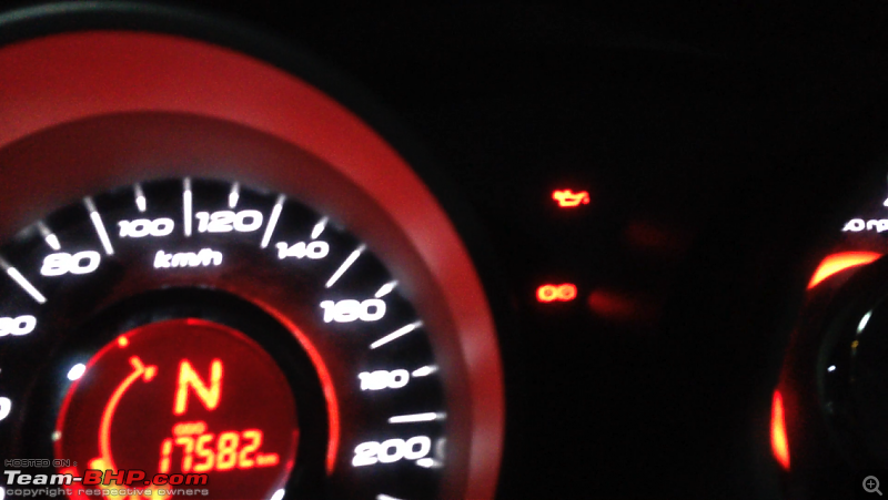

Guys, I think there is some serious issue with my XUV and the service centre guys are also not able to detect/help! So need some URGENT HELP!
The problem is when I start my car in the morning or at night time after a day's rest mostly and sometimes even after few hours of rest, it starts making this strange Kat Kat noise. the noise is like theres no engine oil at all. then after a minute or so it goes and the car gets back to normal. this noise is not your regular knocking sound which is present in diesel engines. and also the Oil Lamp shows on when this thing happens.
usually it lasts for a minute or so but the last time it was on and on for 2-3 minutes, thats when i took video. after that I stopped and restarted the car and it was gone.
also this thing has started from a couple of months I think. earlier it never happened. I had also complained about the same issue with the service centre guys and told them that maybe the oil level is low so please get the oil at my place and check for leakage as I won't be able to drive the car to the service centre. and two guys showed up also at my place but that time it was all fine and the noise didn't start at the start up and they also checked the engine oil level which was normal. then it started again so I took it to the service centre and kept my car with them for a few days but they didn't find anything unusual and it didn't show any error. also when I went there to take the deliver, I was told that the car was lying there since yesterday and not moved or started. but when I started there it didn't show the same problem in front of the RM!
So I am again going to take the car tomorrow and keep there and maybe go there again the next day and start again in front of the RM and the technician so they can come to know the exact problem.
my cousin also has a XUV and he told me that he had faced such problem in his brand new (barely a week old) XUV and his car was towed to the service centre and some part which releases the oil into the engine was replaced. and he advised me not to drive the car till then as it can damage the engine. but the RM said I can drive as its normal for the car to make knocking sound at cold start till the engine oil reaches the engine. but this isn't the normal engine knocking at all and has started recently. never faced this problem in the year and a half almost. also I stay in mumbai and not some cold weather that cold start would be an issue in this scorching summer heat. also the problem is usually at morning and night time. not much at afternoon time.
So has any XUV owner faced such problem and if yes how was it solved? what should be done.
I have also taken a video with my iPhone which is in .MOV format and around 89.5MB. so I am not able to upload the video here. is there some way I can upload it here so you guys can see and know the exact problem?
P.S. - My car is 1 year and seven months old. has run for around 17500kms. the third free service is still not done as I am waiting for the car to touch 20 thousand kms. I had replaced the engine oil once after 1000kms as advised here on team-bhp and then I think it was replaced at 5000kms by the company.

Do you see the low oil pressure light when you hear the sound? If so, please turn your engine off immediately.
This I believe is an intermittently failing oil pump. I had this issue in my car and the oil pump was replaced. The oil pump is fused to the timing case in the mHawk engines and hence the entire timing case needs replacement.
Please don't run the vehicle with the oil pump in this state, it can cause serious engine damage, in the worst case an engine failure. In my case there were a very minor scorings on the rings around the crankshaft (please forgive me if my terminology is wrong) and those rings were replaced.
Please have your ASC analyze this angle as this is most likely what you are facing.

Yes I do see the Oil light on when I hear the sound. the sound and the oil light usually goes in a minute or two. then it becomes normal again and I drive the car. have tried to explain different technicians and RM from mahindra the same but they are not ready to understand and say that "abhi kaha hai?" don't know how to explain them. so I have taken a video of the same and will show them. hope they will understand it then at least.
also you have said that because of this you had minor scorings on the crankshaft, which were replaced. but how would they know if there is any damage inside the engine due to this oil pump issue? coz it would be really difficult to explain them and make them accept and check the engine for any damage. I doubt they would do anything. I am fed up of the mahindra service staff incompetence, that will think ten times next time before buying any mahindra product!

Old 12th June 2014, 12:53   #2670
Vid6639's Avatar
Posts: 14,797
Thanked: 21,086 Times
Default re: Mahindra XUV500 niggles & solutions
I suspect oil pump issue as well. Don't use the car if the oil light comes on. It means that the oil is not being circulated properly. As a result the parts are not getting lubricated and will get damaged. Hence the rough sound when you start the car.
If not attended to it will lead to engine seizure and will be extremely painful to fix.
Vid6639 is offline   (2) Thanks Reply With Quote
