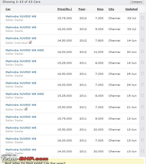

I was looking at used cars in Carwale.com and found a number of XUV5OO with very few kms clocked on sale. I also found quite a few XUV5OO on the classified section in Hindu last Sunday.
Wonder what could be the reason that a number of owners want to sell their vehicles with such few kms on board. If it is due to the niggles, I simply hope Mahindra is able to sort out the issues with the car, else the high sales will soon be a thing of the past.
