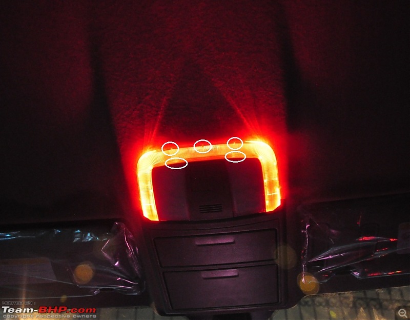

I have a doubt about my XUV.
The dome light in my car appears like the picture shown below.
What I have marked in white circles are what I believe are small LEDs which are either not working or are significantly weaker than the remaining LEDs in the same part.
Can other owners please check and comment?
SDP is offline   Reply With Quote
Old 8th November 2012, 23:37   #1125
debuda's Avatar
Join Date: Sep 2012
Posts: 409
Thanked: 1,308 Times
Default re: Mahindra XUV500 niggles & solutions
Attachment 1012355
After reading your post, I checked my own car. My light looks similar.
IMHO the dots you have circled are not LEDs but built-in protrusions in the plastic cover which are used as fasteners for locking the cover in place. When light passes through a transparent / translucent object which has different thicknesses or appendages in different areas, the brightness of the emerging light appears non-uniform due to varying refractive index and attenuation of the different areas.
debuda is offline   (1) Thanks Reply With Quote
