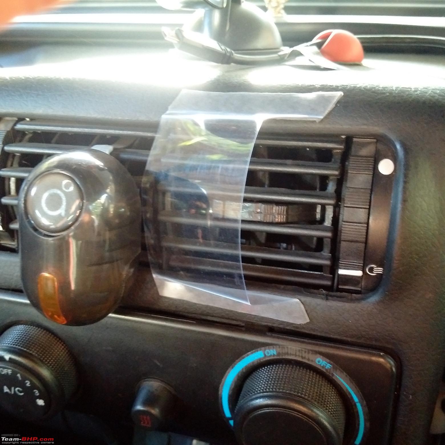

A DIY "Jugaad" to improve the airflow towards the driver in the Thar,
Mahindra Thar : Issues & Solutions-diy_deflector.jpg
PreethamB is offline   (2) Thanks Reply With Quote

Hi PreethamB
Had earlier tried the same out of frustration but the flap makes noise and was a bother, but then my son brought in a thermal camera and i thought i could put it to good use.
Found a simple solution that works on basis of surface adherance and flow dynamics.
Put some rainx "original" using a cotton bud on the angle you want towards you on the fin lips at a 30 Deg Angle ( Since i drive mostly alone did the same on 3 vanes and obviously the 2 central ones yealded the best results)
>Rainx Applied Side<
Allow it to dry for 10 min and then dont wipe. Try the ac now.It will now blow easily towards your side, and no obstructive physical mods required
( This was largely a trial and error effort tried some of my DIL's Nail enamel, Car Polish Wax,Silicone oil and checked on the flow using a thermal camera and an anemometer combination and Rain X aka original passed the test in flying colors )
Give it a try and beat the sweat out of Thar ;-)
Vinay Stanley is offline   (2) Thanks Reply With Quote

Originally Posted by Vinay Stanley View Post
Hi PreethamB
Superb! Could you post a pic while circling the area to be applied. Am i right in assuming it is the vertical fins?
I have used a fairly stiff sheet of plastic and hence it doesn't flap around and make noise. It may also be because it is held stiff on 3 of the 4 sides; 2 sides are stuck with 3M double sided tape and the other is stretched over the ends of the slightly protruding horizontal fins of the adjacent vent.
I was going to replace the deflector I made with one fashioned from Door Visors in a hope to make it look a little better, but you seem to have found a much more elegant solution. Thank you
Let me try applying ProKlear since I already have that with me. If that doesn't work, I am going to go get a bottle of RainX!
PreethamB is offline   (1) Thanks Reply With Quote

Originally Posted by PreethamB View Post
A DIY "Jugaad" to improve the airflow towards the driver in the Thar.
Dear PreethamB and Vinay Stanley - this problem is there on many vehicles of many manufacturers, not only Thar. The acceptance criteria should be that the center line of the direct airflow from the blower must cover the driver torso location at all the slots in which the seat locates in the X axis (longitudinal). More often than not, this is not taken care during louvers design, forcing you to get into all sorts of juggad. One way of overcoming this issue is to buy the small rectangular swishblade type car fan (these are available at accessory shops) and mount the swish portion on the blower louvers. This gives oscillating motion just like the house AC. I have seen it fitted and working very effectively. Try it out, you will need a lot of patience to integrate it into the existing system.
In Thar specific application, remove the louvers and file off the bottom supports to increase the angle of travel. I had done this on the prototype and it gave very good result. Finally, it is all common sense! .
Best regards,
Behram Dhabhar
DHABHAR.BEHRAM is offline   (2) Thanks Reply With Quote
