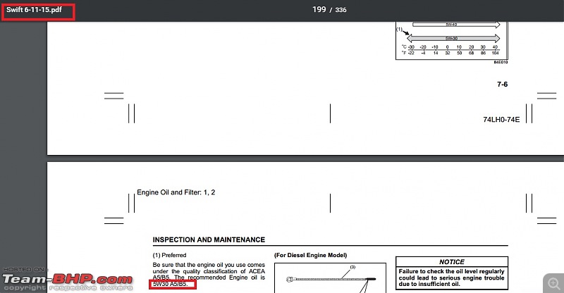

HI,
Mine is 2015 April model, swift ZDI and run 35,000kms. As my 40,000km service will be nearing, Iím confused with the oil grade. I have used fully-synthetic oil right from the beginning. I do not know the grade but did all services at MASS, choosing fully-synthetic always.
I see in the thread that, the circular is of 2012 and even downloaded service manual from Maruti website, dated 06/11/55 and it recommends 5W30. Attaching the below screenshot for reference.

Originally Posted by bkc View Post
HI,
Mine is 2015 April model, swift ZDI and run 35,000kms. As my 40,000km service will be nearing, I’m confused with the oil grade. I have used fully-synthetic oil right from the beginning. I do not know the grade but did all services at MASS, choosing fully-synthetic always.
Go with what Maruti folks at the service centre. They generally stock Mobil/Castrol/Shell 5W40 for diesel engines.
I have a Swift ZDi too but a 2013 one.
Been filling 5W40 oil since day 1. Been 12 services till date (1.03 lakh kms).
a4anurag is online now   (2) Thanks Reply With Quote
