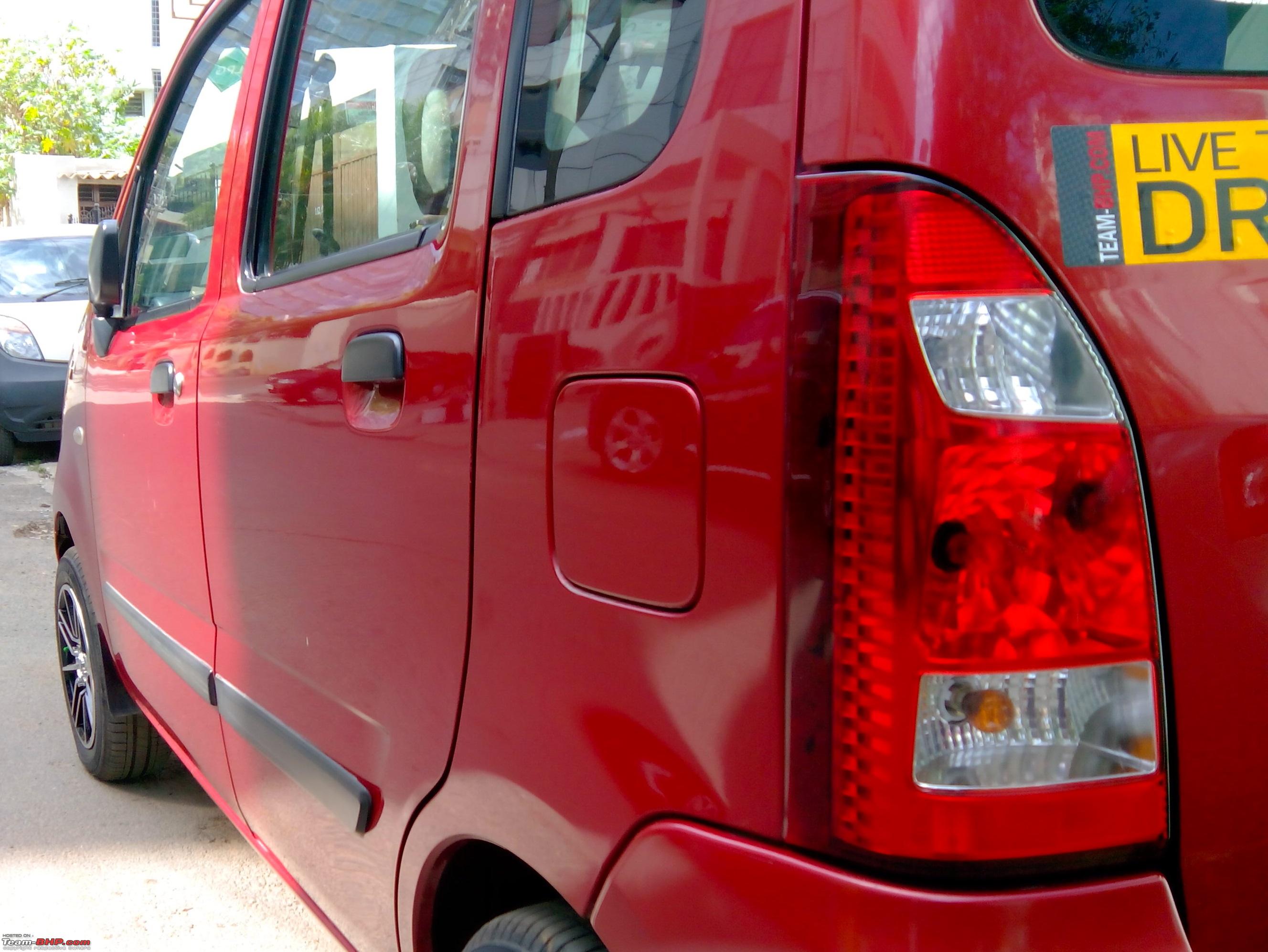

Slightly glossy but super reflective
Buttery smooth to touch

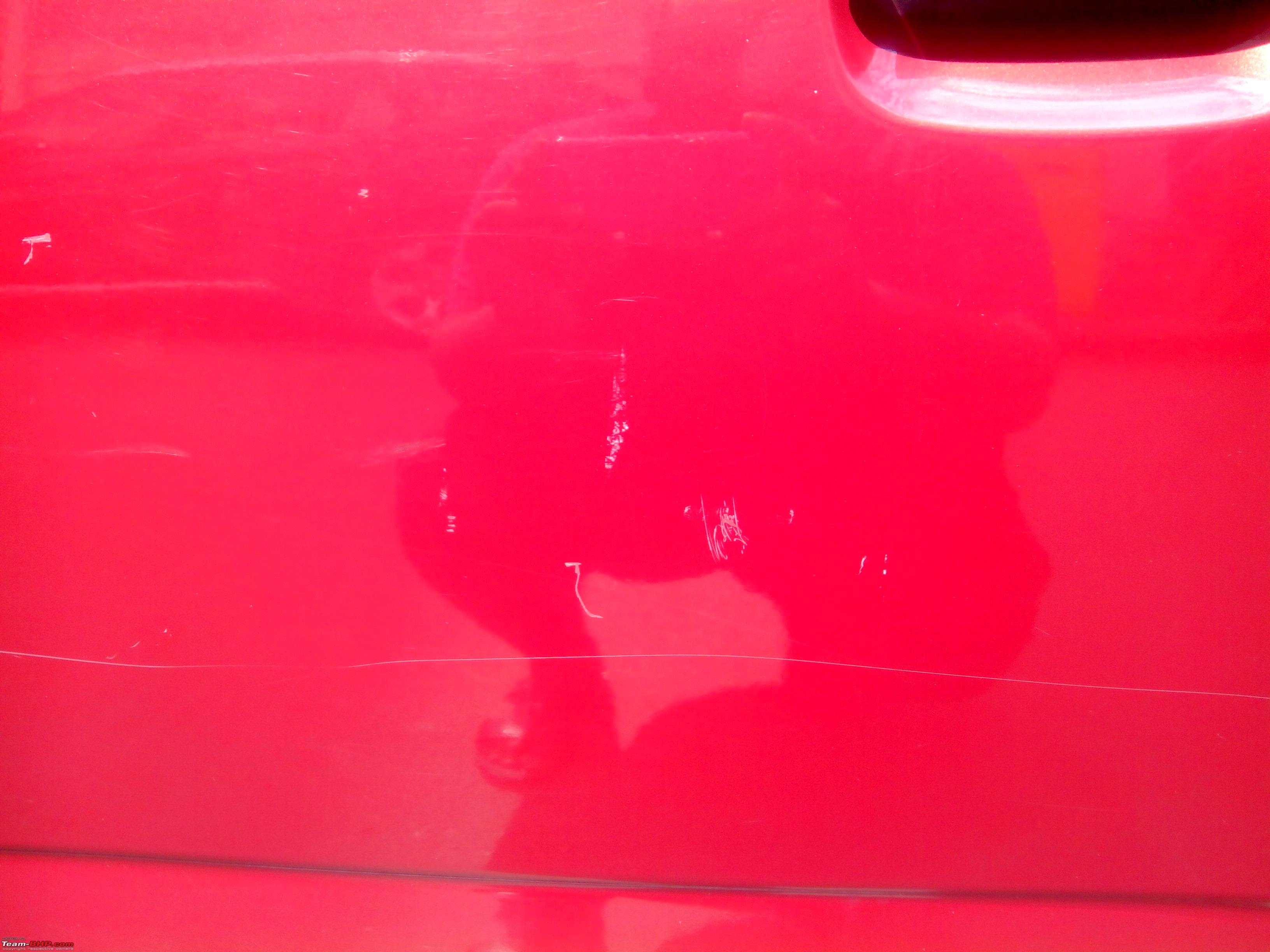

Scratches still visible. Did I not use enough wax? Or do I need something like Col 915 to fill these?

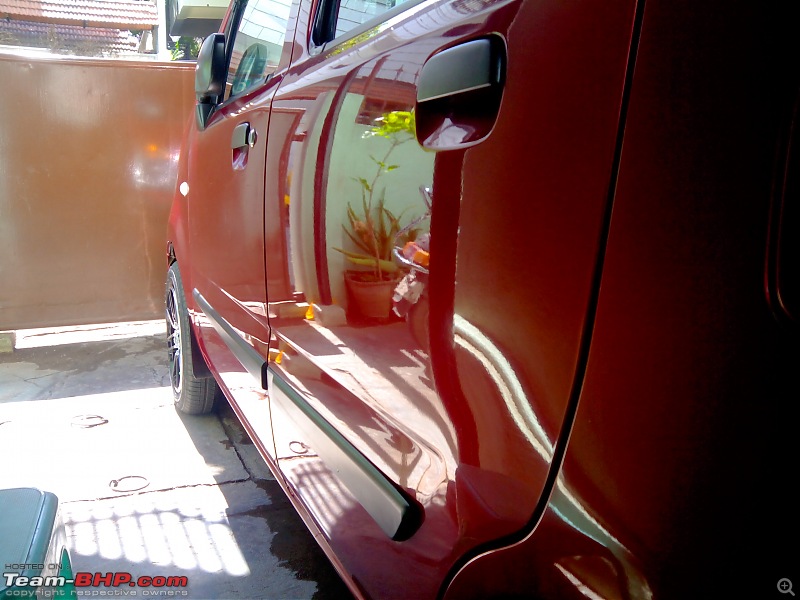

Nothing cloudy about that!
The Wet Black look

Good first try. Did you have to apply pressure on the clay block while claying?
Those scratches seem deep, the clear and the paint coat seem missing. If that is the case, only a repaint or touch up can add paint to it, not any wax or sealant.
thoma is offline   (1) Thanks Reply With Quote

No pressure. Just gentle anti clockwise swipes with lots of lube.
Plan to take it to Trend auto in Feb and get all the dents and scratches fixed. Was even considering a repaint but I think I will put that off till mid next year
