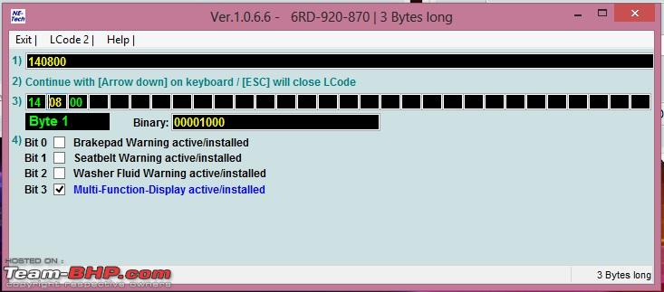

Originally Posted by robimahanta View Post
Hi Robi, Can i activate the washer fluid warning lamp and brake pad warning light? I have a 2014 1.5 Polo TDI with the stock instrument cluster.
nidhinsarath is online now   Reply With Quote
I believe that is applicable for the Laura. Not the Polo. I had activated the wiper washer fluid low level light on a colleague's Laura sometime back.
