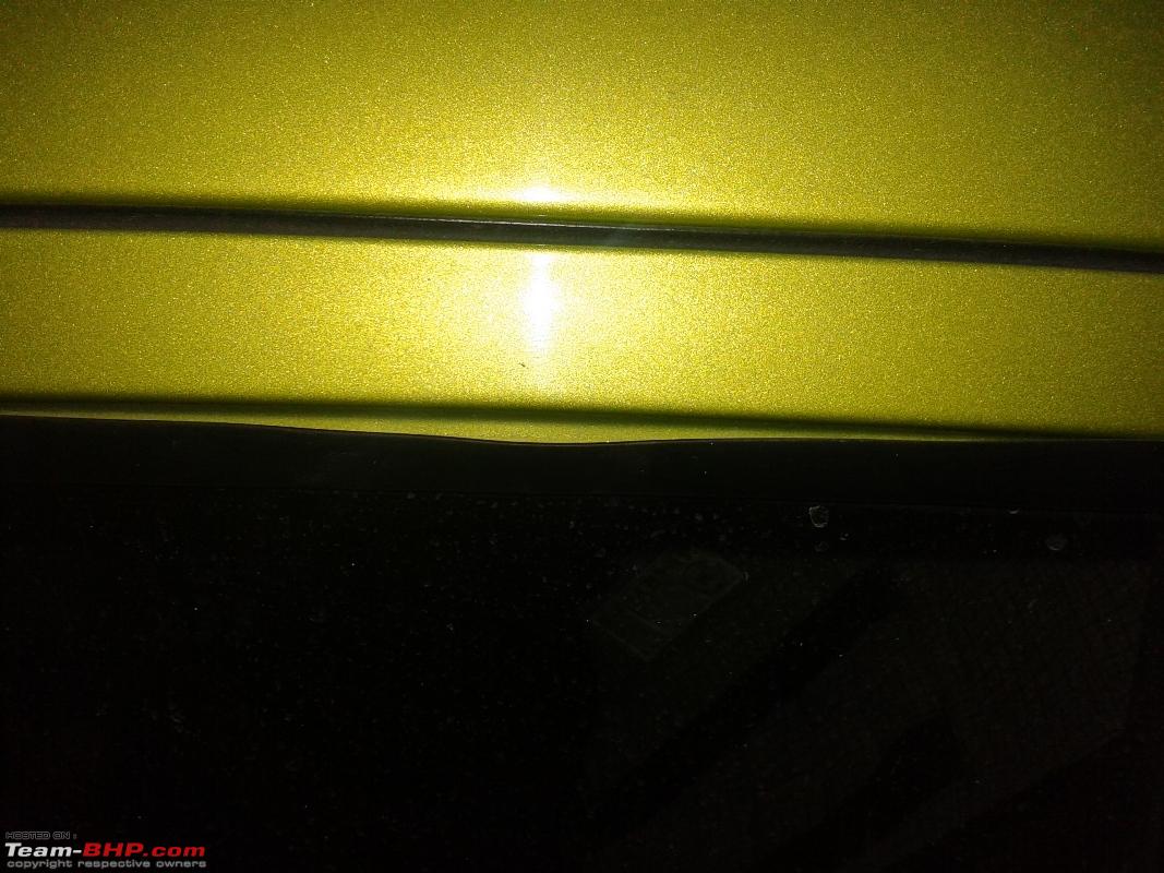

Recently when I was cleaning the car, about a week back, I noticed that the rubber beading on the door panels had become loose. I tried to put it back and then I observed that the door panel beneath the rubber beading has caught rust and the metal was disintegrating.
My service was due and I decided to take up the matter with Kropex Chevrolet when I visit them.

Loose Door Beadings (I observed this at home)

More than a case of poor sheet metal, to me it seems like a faulty door beading. I assume in case of a water wash or rain, water is entering the rubber beading's and it didn't get a place to come out or dry up fast which eventually caused the rusting. When Chevrolet takes up your matter and fix the problem you should ask them to check/change the rubber beading too. If its faulty then the problem will reoccur. Rust in these places were common in older cars like Fiat's or Ambassadors or even in Maruti 800/Omni due to water seepage but with these new generation cars its not acceptable.

Yes, that is the root cause of the problem. I was banging my head as to why I did not check under the beadings for rusting.
But then who does remove beadings and find if there is rust under it.
3 Doors are affected and was discovered just because it happened so that while wiping the car with a microfibre cloth, it got stuck to a loosebeading and whle putting it back I saw the rust.
I dont know of other non-accesible parts of the car where similar rust may have developed.
I would say that thisis due to a manufacturing fault at the paint shop. A well painted part would not catch rust so easily.

I stay in an apartment with basement covered parking. I was and wipe the car on my own and have not appointed any washing guy.
I haven't tried to sell the car anytime. So there has been no manual force to remove the beadings.
Originally Posted by Maverick79 View Post
I feel sorry for the situation, Soumyajit9.
One of my close friends faced a similar situation few years ago. He is based out of Lucknow.
One fine morning while he started cleaninig his ride himself, he was shocked to see all the 4 doors bottoms were filled with rust.
Beadings were doing their job good. But the reason was manily due to the poor paint finish.
After lots of complaining and a final frustated mail to then GM India CEO, things were replaced and repainted.
Pls don't leave or accept anything for a compromise.
All the best.
Wow, that is even more tragic than mine !! How would one ever go and check what is happenning beneath the door ! Eye opener for me. May be even I should check that part on my car.
I am not leaving this issue. Will follow up with the Zonal Area Manager to check the status of my complaint, after 3 days.
