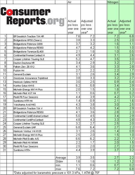

This nitrogen filling is a joke. And i am surprised everyone falls for it.
Better ride and handling - comeon, if a gas in the tyre can do so much then why didnt it come company filled.
Air(non polluted) in the troposhpere(the lowermost layer of atmosphere) where we inhabit is made up of 78% nitrogen, 21% oxygen, 0.9% argon, 0.03% carbon dioxide.
So when someone says 78-80% pure nitrogen - trust me he is filling normal air into your tyres from a gas cylinder that says nitrogen on it. And believe me he is not fooling you.
When someone says 97-100% pure nitrogen as used in industries, it needs to be stored in liquid form and immediately utilised when turned to gaseous form. Even in this form there are 5-10 ppm of oxygen in it. Now the problem is to handle such pure nitrogen the equipment required is quite expensive - so the tyre shop below the flyover or one down the street probably does not have "pure" nitrogen. To make economic sense of supplying pure nitrogen for tyres he needs to install a capacity to fill the tyres of every car in a city like Mumbai EVERYDAY.
Check the survey done by Consumerreports.org ->

Hey sorry but i really dont get the consumer reports sheet. Mind putting some light on what those figures mean?
