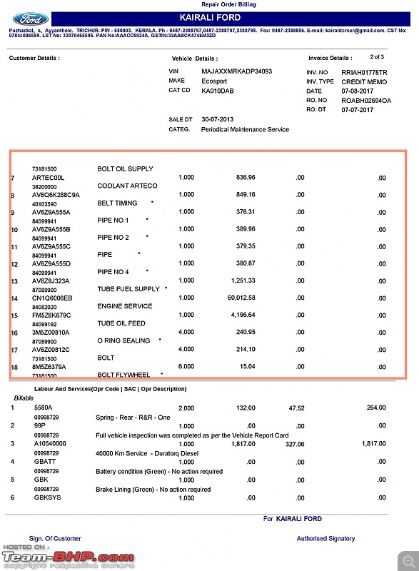

The Piston had cracked in my engine and thereby burning the engine oil. After the preparation of investigative report by the dealership, Ford approved a new TDCI engine for the EcoSport. And the engine crate arrived in two weeks. A relief at last. The car completed the 40k service and was delivered with new engine. Dad called up to say he is very happy with the car now with good miles under the belt and says it feels good as new. But I was unable to verify whether the new engine tune is different from the earlier one.

EcoSport 1.5L TDCi: Engine seized, replaced without a fuss by Ford-page-1_bill_ecosport.jpg
EcoSport 1.5L TDCi: Engine seized, replaced without a fuss by Ford-page-2_bill_ecosport.jpg
EcoSport 1.5L TDCi: Engine seized, replaced without a fuss by Ford-page-3_bill_ecosport.jpg

Asking since the engine assembly is mentioned as 60k INR, which seems very less?
Could be to play down warranty costs on the company's balance sheet.

Originally Posted by johannskaria View Post
Even i had the same doubt, but i was told that the whole engine was replaced and they had to do engine number transfer done to the new block.
Even if its block replacement they would have to print new the numbers, since the block has the number on it.
Nope not likely, i think it is just engine block, pistons etc
